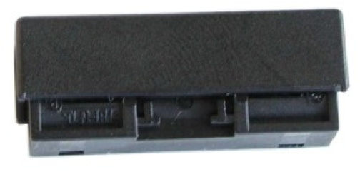

If you send me an email, I will rep;y with a photo.
If you go to the MB parts department, ask to see the two kinds of FO butt connectors they have, look at the part, and you will see that it will have the AMP PN 1355734-1 on it.

Well I took pics of what they gave me using that part number. On the receipt it has a MB part number 000-545-33-84. Here are the pics, I dont have a lens that allows super close up so this is the best you get. Let me know if this is the correct butt connector adapter.

Ok here we go. The pics I posted in post number 23 and the MB part number are what you will need. This is a 5 minute process once you have everything together.
First make sure you have a number 20 torx screwdriver. That will be needed to remove this screw
Next it takes a bit of effort to remove the changer, just take your time and wiggle it out from the right like previously told. It will come out. Once you have it out there should be plenty of cable to work with, dont worry about anything getting snagged. Once you are looking at the back you will see two cables and they would be in this location.
Where the green color is where the orange fiber optic cable goes. Unplug that and the other wire. The FO cable is connected with this connector.
Just pull out the grey part and that will easily allow the optic cable to come out.
Now there are two color for the optic cable, one red and one should be a grey color. These go into your connector you purchased. They are end dependant, meaning the red will only go in on one side of the connector and vise versa. Once you have those in the connector push down on the tabs to lock it in place and hide your cables. Now its out and everything works as advertised. I had no error message, same as knuts said. GL.

That is not the same as mine. See the attachment
Attached Thumbnails How to remove the CD Changer in glove box?-amp-1355734-1.jpg
