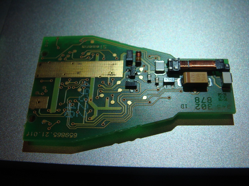

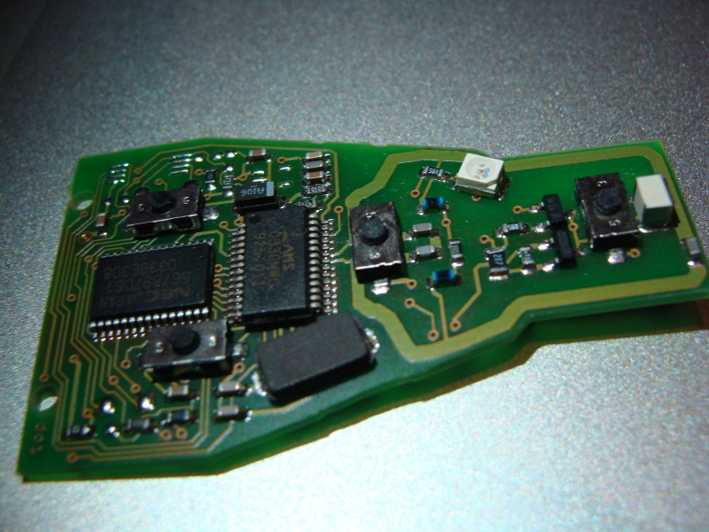

Please note the key is inductively energised by the EIS.
https://mbworld.org/forums/c-class-w...t-process.html
Attached Thumbnails Smart Key Wet-6f9wfo.jpg   Smart Key Wet-dsc00490.jpg   Smart Key Wet-dsc00492.jpg
