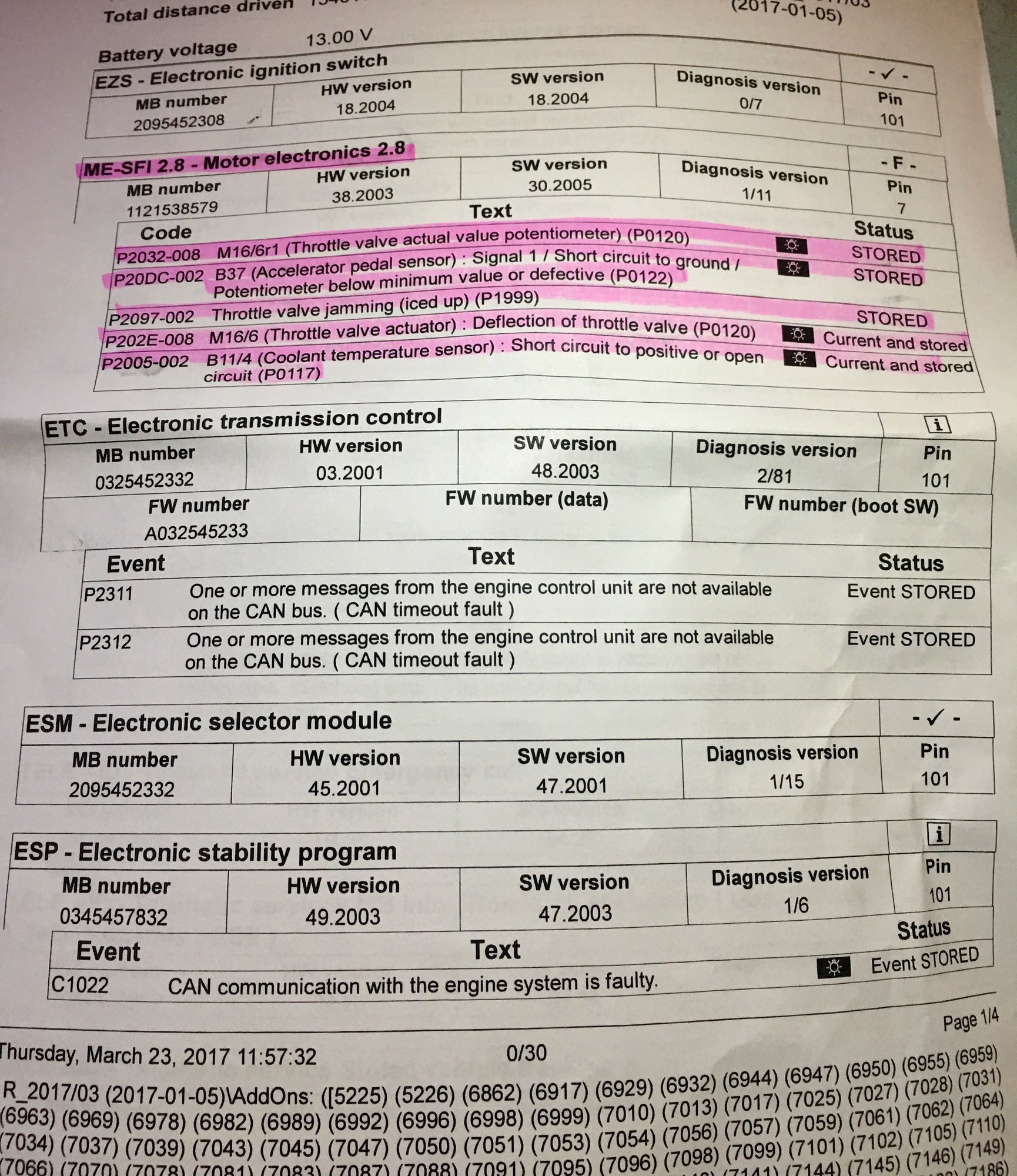

I just came back from the dealership after having some strange issues with my 2005 CLK 320 and they say I need to give them almost $2000 for a new engine control unit, but I am skeptical.

This morning the car did start up normally, but the check engine light was on so I took it to the dealership to have them run the codes, and the guy there told me that there were throttle valve issues and I needed a whole new engine control unit - which incidentally only they could replace and reprogram.
They said they thought the seat issue was purely coincidence but ... it was all very odd to be just a coincidence. The car was fine before the seat, and it has been driving well and no lights are on since they cleared the codes. Did I maybe flood the engine when I was trying to crank it last night that could have caused the codes to come up? I just had the car in for its bi-annual service and my indy said everything looked good so I don't want to shell out thousands for something that isn't needed now.
I am posting a screenshot of part of the code report from the dealership just in case it might be helpful - there are some other faulty CAN communication codes with things like the rear-SAM, and the control unit SAM on other pages but the guy there seemed to think the page posted below was the most important one (the highlighting was done by them).

That does seem very odd. It also does seem like a coincidence with the seat issue. The fact that it started up when cool sure sounds like a bad CPS. But it does not look like you have a bad CPS code. Do you have the car and is it running fine?

I doubt the seat issue has anything to do with the ECU issues. But, I see NOTHING in that diagnostic report that indicates bad ECU. You need to find another shop.

Fix the two "current" codes, clear the codes, then drive it and recheck.
