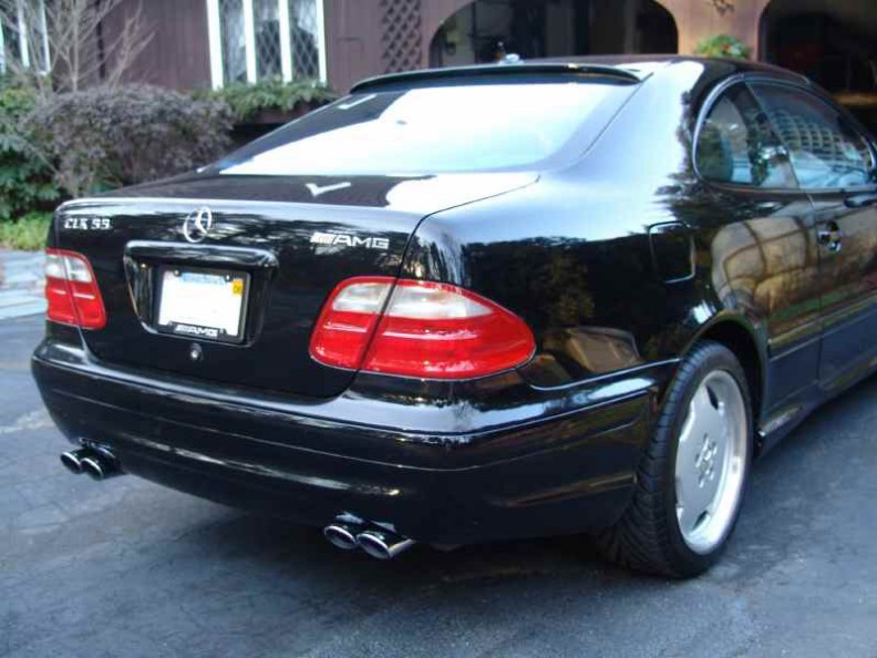

Here's a pic of CindyCLK car with dual exhaust (looks nice)!

Thanks - the car looks great like that. I need to take a look under the car when it arrives and see what can be done. I may take a ride to te MB dealership and see what they have on the parts system - maybe they can tell me if I can just order up some stock MB parts to get the quad look from the coupe.

The answer will be no...They do not sell the AMG tips alone. You have to buy the exhaust system. (the ebay sale of tips is a good deal). The bumper must be modified by someone who knows what they are doing. The actual attachment of the tips was the easy part. Hope that helps.
