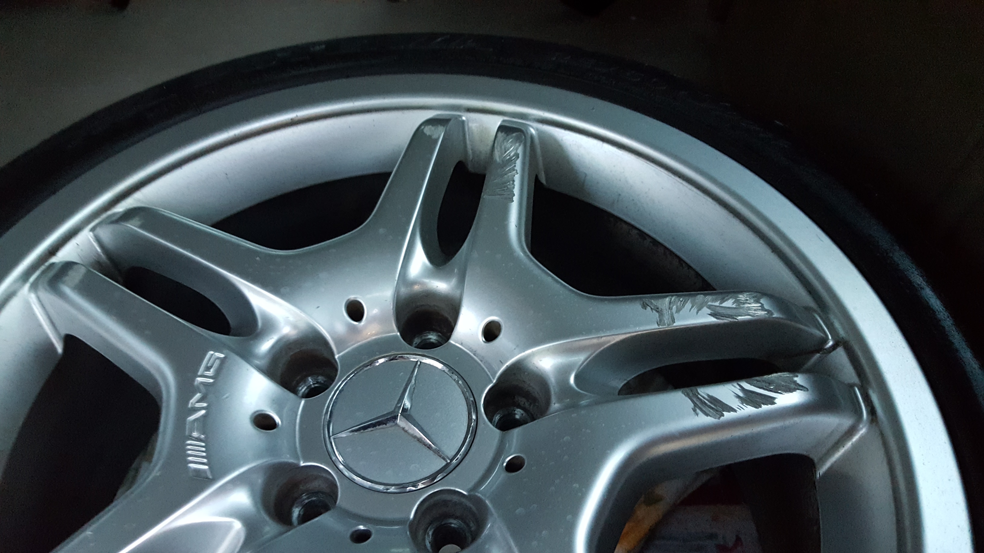

Tomorrow I'll be pulling off all 4 wheels to get the rims refurbed and new tires put on, then hopefully we'll have many years of enjoyment without too many issues.

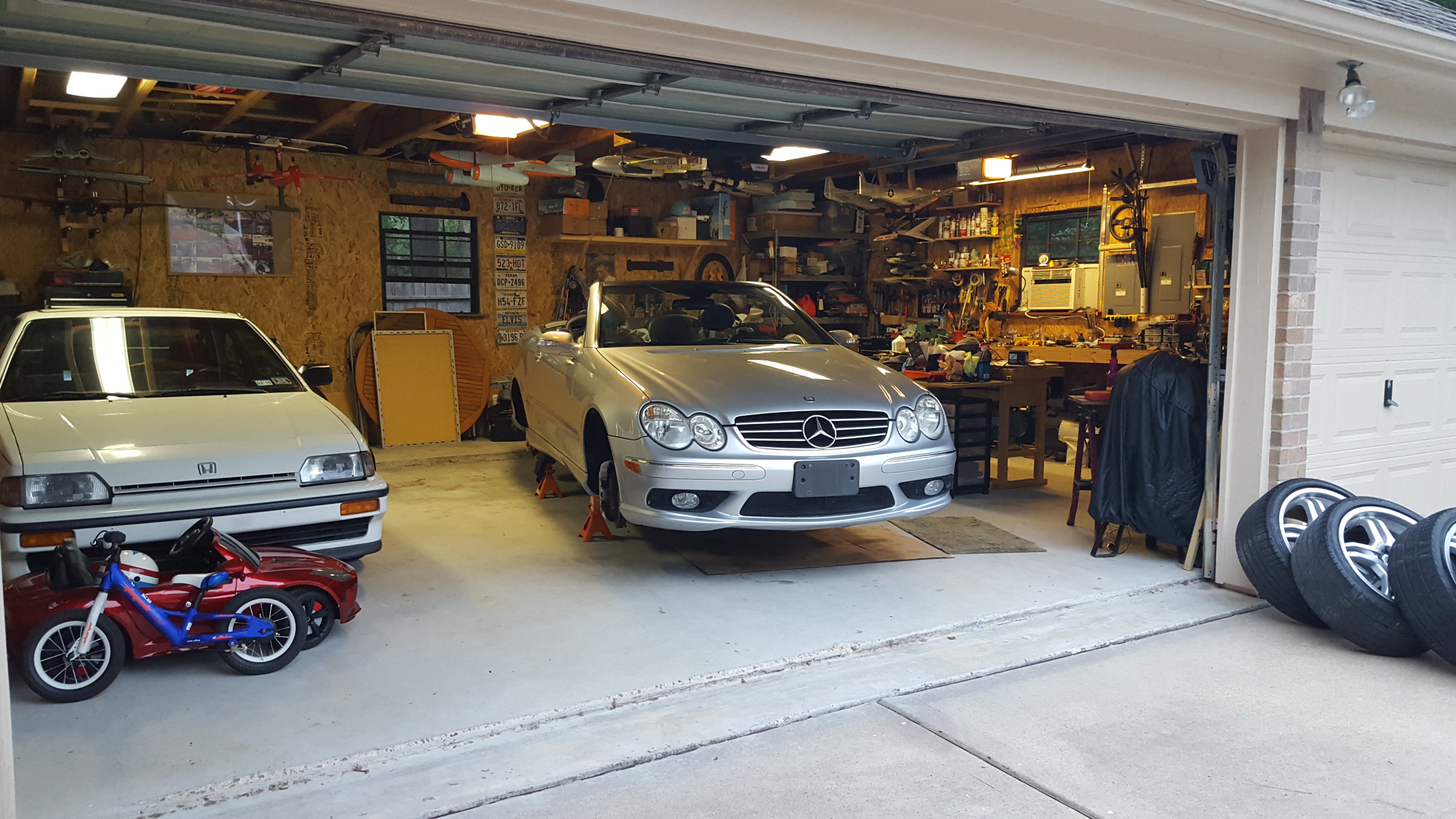

Per her up on blocks last night and just dropped off the wheels for tire removal. He'll pick them up later and go to a couple rim refinishers for quotes this afternoon.

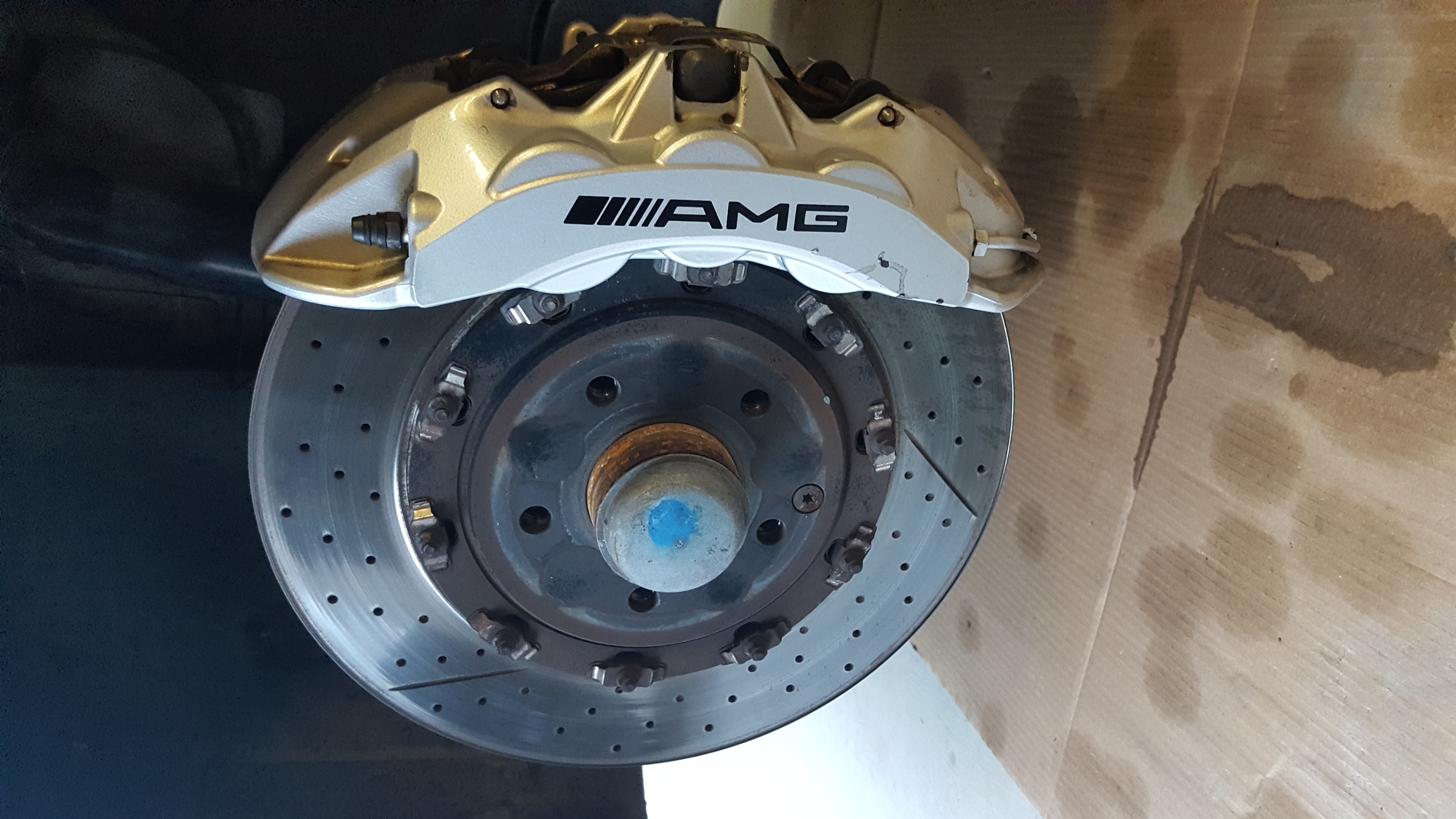

Love the brakes!!!

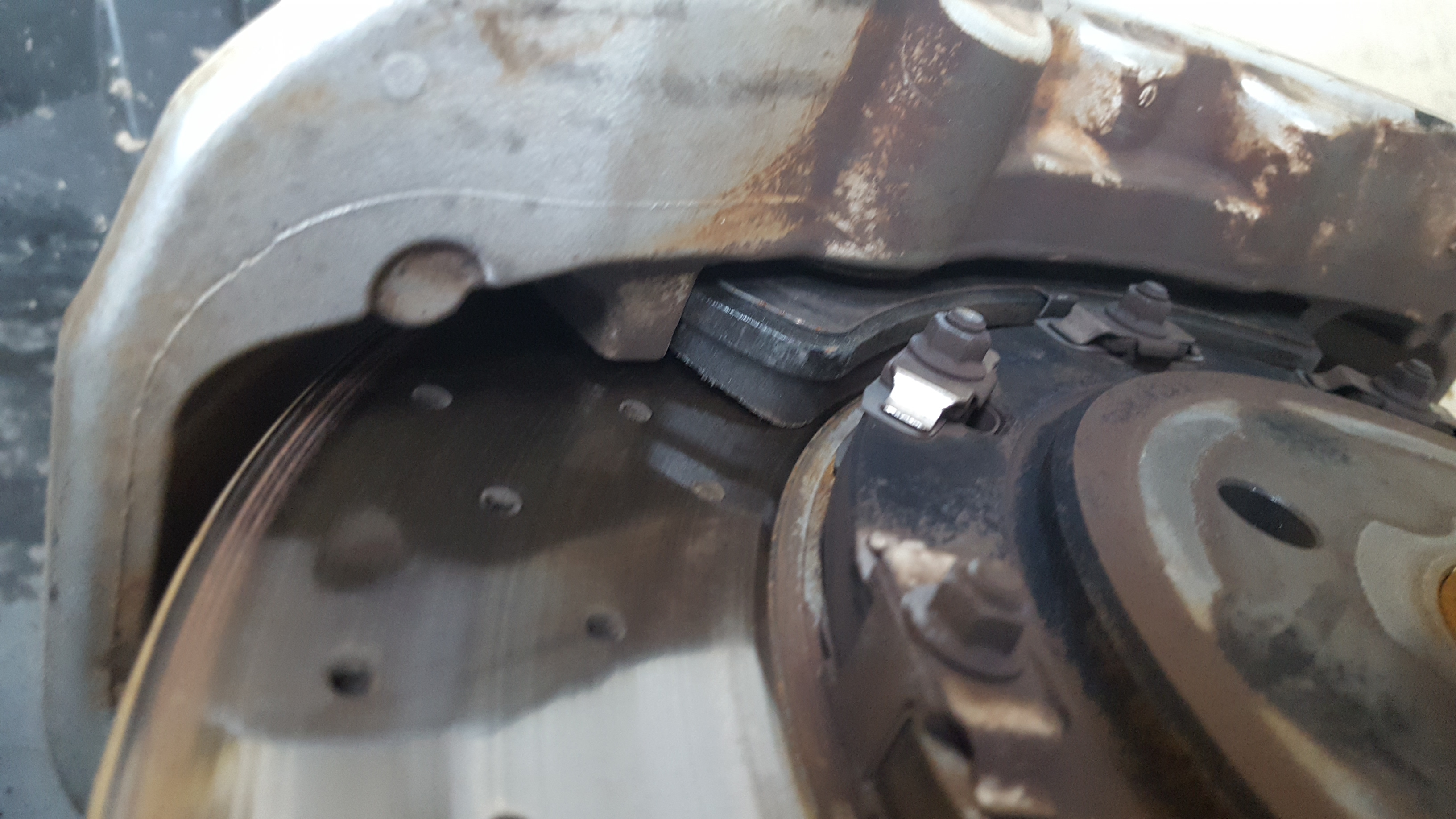

BTW is the brake pads wear normal? I've never had 6 piston calipers before, theyou feel great but the angle of the pad surface in the last looks strange, or?

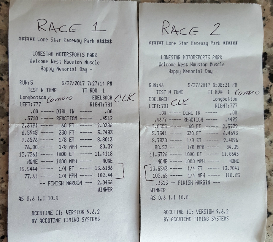

1/4 Mile: 13.55 @ 103mph
Took her to the dragstrip last night and had a blast.
Two runs were nearly identical so didn't feel the need to push her for more.
Compared to my buddy in a 2012 Camaro SS with ~500hp the CLK was stoopid easy to drive. He was losing traction in the 1st three gears while I just mashed my foot to the floor the whole way.

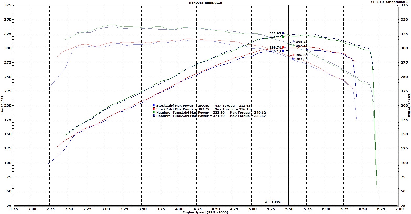

Same here, plus Kleemann headers

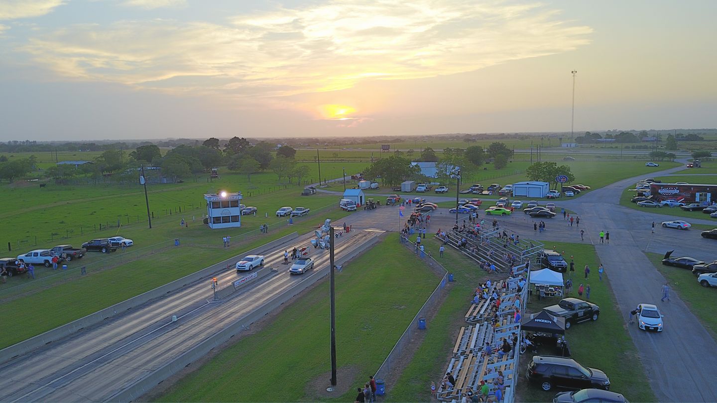

Here's a pic from a drone of our second race, hoping to get aerial video.

Hey man lovely car and congrats to you and your father. Sorry to bother but I saw one of the photos your Civic was next to the AMG in the garage on tressels/jack stands. Can you put up a photo as to how you placed the car on the stand or do you have that special pieces that go into the groove of the jack points on the car? That is a Civic not? I liked that old shape. Pity we never got them in SA
With regards to the brake pads, I have seen mine look the same. However I thinnk if you remove them they dont look entirely like that but I could be mistaken. Last time I replaced mine, they were clean of any asbestos and down to the metal.

The white Honda is a 1986 CRX Si, known as the Ballade in Japan I believe. Almost sold it a few years ago, then realized that the $4 or $5k I could get for it was not nearly what it's worth to me. Only ~85hp but also only ~2000lb, a real treat to take out every now and then:
I used jackstands with rubber heads under the stock Mercedes blocks. Not the most secure way to keep it in the air, I always kept the jack under the front center jacking point when I was underneath it.
Thanks for your input on the brake pads. I pulled a set out to inspect them and they're indeed wearing nice and even. The edges of the pad are chamfered, so I think this is what I was seeing in the pic above that gave the impression they were wearing unevenly.

I read somewhere as I am always asking people how are they supporting their vehicles with the jack stands. Apart from the adapters you can buy for them, some people used wood cut into a specific shape to go into the hole of the jack point and then rested that on top of the jack stands.

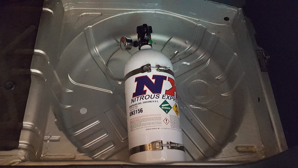

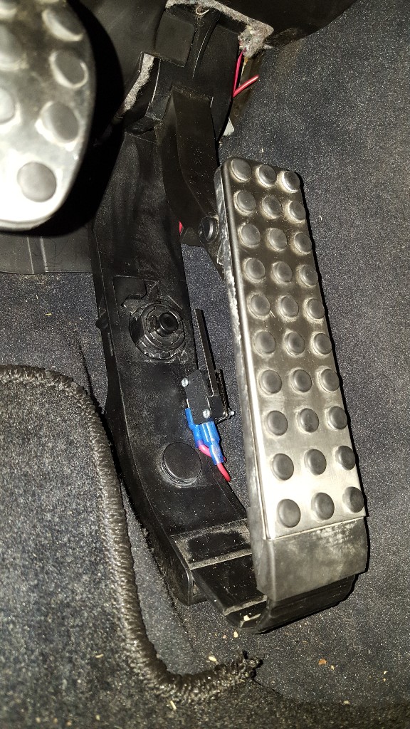

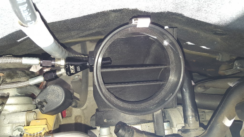

New mod: Proton Plus N2O system.
Going back on the dyno soon.
With 50hp nozzles 50-100mph time dropped from ~8.3 seconds to 7.2
