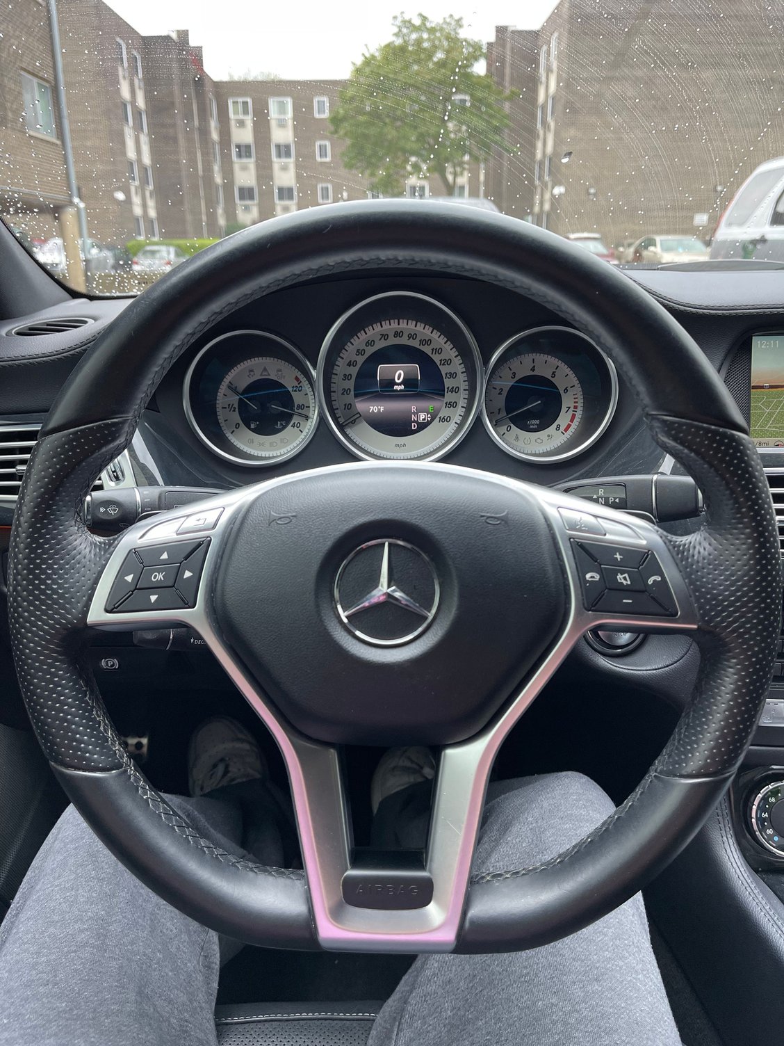

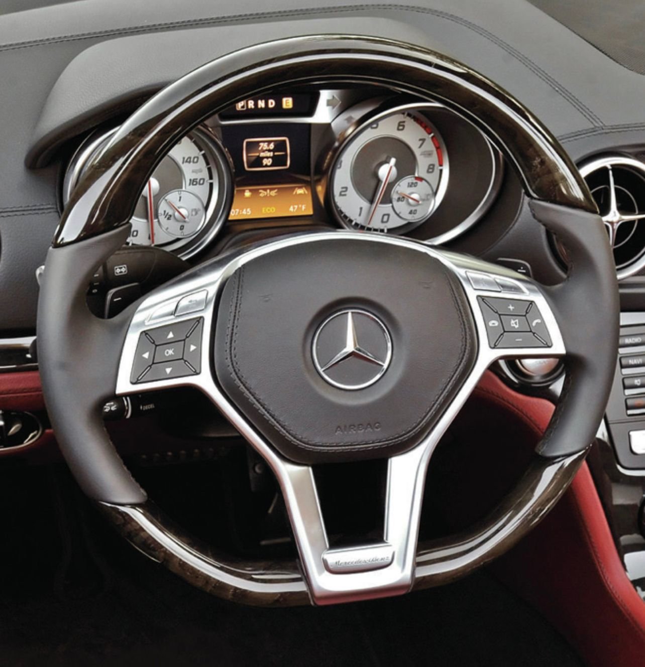

I am swapping a 2015 sl550 wheel into my 2014 cls550, will this be a direct swap being that the wheels are the same design ? pictures are below.
current wheel
new wheel

I believe that should be a direct swap but make sure the donor wheel has the shaker if your car has lane avoidance.
If you do the swap, would you interested in selling me your old wheel? My '13 CLS550 has wood/leather wheel and I want all leather (I'm in hot Phoenix).

actually his car was not optioned with lane keep assist will that cause issues for me ? my car has the option

If you open apart the steering wheel you should be able to transfer the motor

is there a way to deactivate the lane keep assist warning light ?
I don't see a separate fuse for just that function - looks like a fuse for steering wheel module.
I don't know if simply turning off lane assist will negate a warning light.

If you turn the setting off before switching steering wheels I have heard you shouldn't have the error.
The transfer of the motor is somewhere in the assembly part
