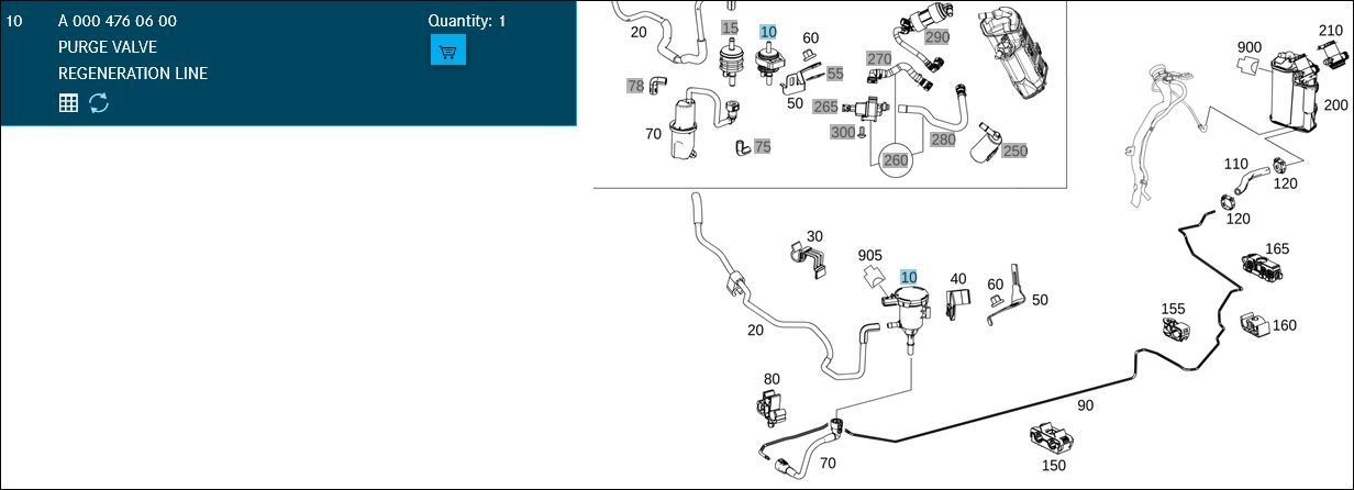

When you say front right driver’s side (looking in) it is actually left side. Another possibility could be purge valve. BTW 218 should be posting here: https://mbworld.org/forums/cls-coupe-c218-157/
