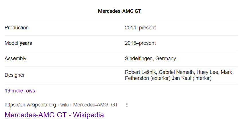

What are you talking about? I think you are posting in the wrong forum. There is no 2014/15 MY AMG GT!

AMG

Ah, thanks. All this time I thought 2016 was the first model year.
