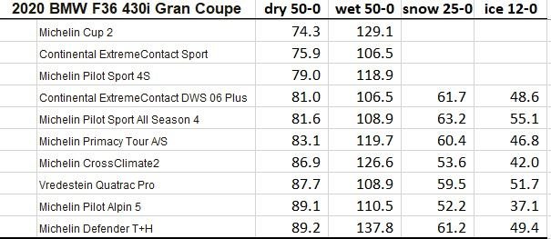

Again above tests shows the results for specific tires, eg Conti 6 for summer tire, and Cup 2 might be worse in wet conditions eg based on tire rack tests (no temp given on tests):
https://www.tirerack.com/tires/tests...y.jsp?ttid=262
  • What We'd Improve: It needs more wet traction to be competitive here."
