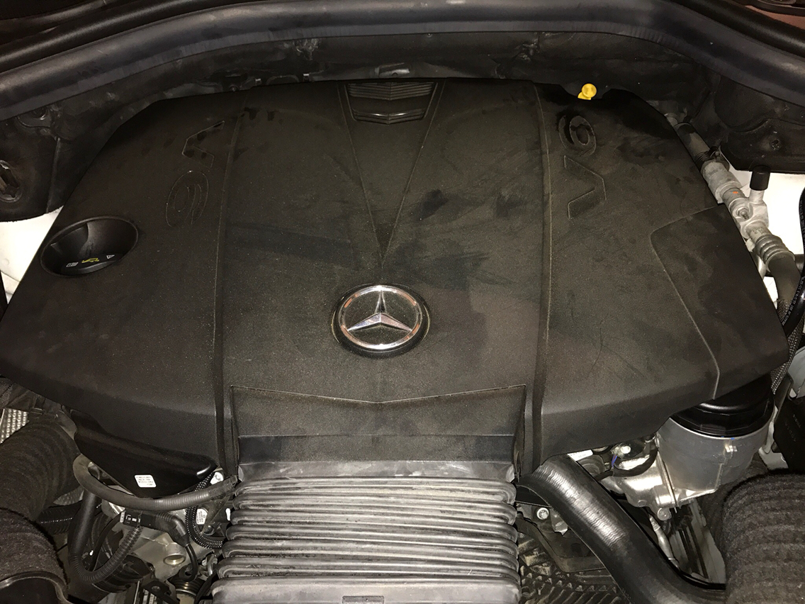

Sorry for the confusion, temp in the range, just thinking if taking cover off will it benefit the engine with a little bit more airflow?
i took my upper and lower covers off for more engine bay airflow
i found grey goopy silicone looking stuff under my engine, turns out it is the motor mounts melting the silicone out (they have a liquid center) from engine bay heat

The motor mounts melting is new to me. Interesting though.
Otherwise, you won't have any real benefit from taking the covers off. Diesel engines have a lot more mass than a comparable displacement gas engine, so they seem to "feel" a lot hotter. In reality, diesels have more difficulty getting hot enough, particularly in cold weather.

I took mine off on my 211 years ago due to concerns about heat soak. so far so good, still on my original turbo and seals @ 118K
Engines mounts on my GL350 were melted when I dropped the belly pans at 60k, so I removed the front belly pan to get a little more air flow. Now at 70k, removed the other belly pan because one of the new mounts is leaking. Might be simpler to move to Nova Scotia than to keep repairing this lemon...

MB engineers the covers to control airflow. See that duct in the front that puts air into the cover area?
Taking them off may make you feel better, but it takes the airflow they spent lots of time/money designing and throws it out the window. Bellypans are there for that too. All the air that comes in through the radiator is supposed to move over the powertrain and out the middle of the car. With the pans out you lose the effect.

you may be right, I'm just not sure.
on older vehicles there were no belly pans to speak of and now the engine compartments are all sealed up with hood pads and gaskets around the perimeter with plastic covers over everything.
i am NOT an engineer but it made sense to me to open up the bottom of the engine bay for low speed city driving when underwood temps soar
my initial thought was to trust the mercedes engineers but 10,000 mile oil changes seem insane and the heat built up under the hood when i open it seems extreme

Hot air goes up, not sure if removing bottom cover will help a lot with air flow when car is not moving in city traffic.

Ever stand next to the car running with the a/c on? There's quite a lot of warm air that gets pushed under the car and out the sides.
I guarantee, if it was up to the engineers, they would use a better oil or more frequent changes. They are being held back by regulations, sales, etc that want less oil usage, simpler maintenance schedules, streamlined maintenance across all models, etc.
If you told a diesel customer he had to change his oil twice as often as a gas car and the oil was gonna be more expensive because it required an actual better oil, they would sell less. Can't have that.
