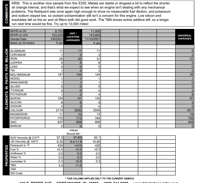

Here is last results for my E250 run on Motul 229.52 category oil. Notice that when FSS or Assyst allows the oils to be run for 12 months, I did 27 on it.
<pic removed>
^ This x 1000000. Use the right oil, and do UOAs to tell you how much life is left in it.
