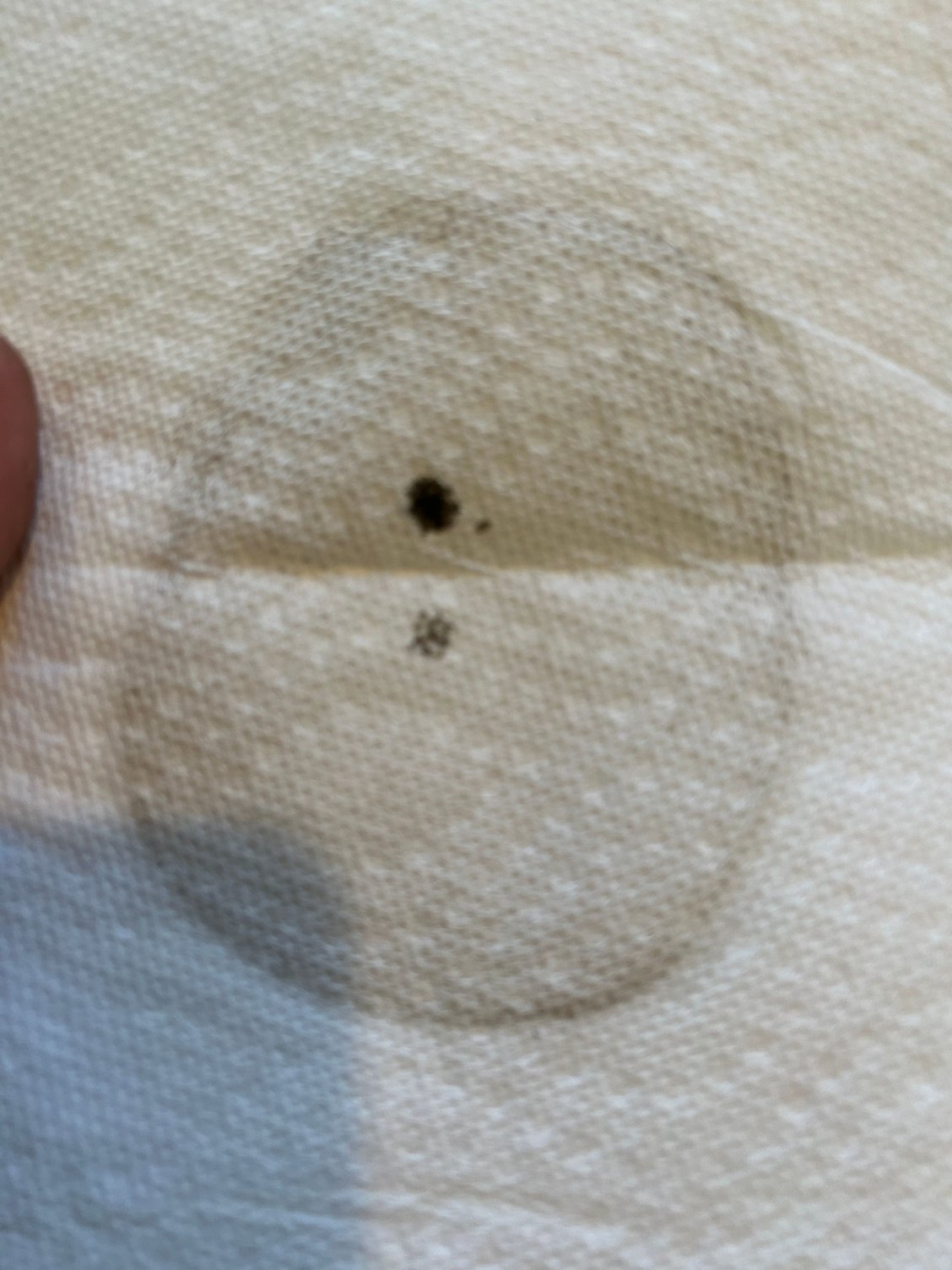

What happens around the 5 second mark? The engine sound changes and the leak appears to diminish.
I believe there is more than this though as for the odor is almost constant and is at the point that your clothes smell like diesel exhaust after spending a few minutes in the vehicle.
I held a paper towel above the rubber grommet and this is after about 5-sec. Good/bad? This was after the smoke stopped. Remember, the engine has about 16,000 miles on it.

I just looked at my truck. What I forgot about when I mentioned putting your hand on there is that because of the location of the opening, A LOT of oil splashes out. So the question is... how come you didn't have much more on the paper towel?
The smoke looks normal given the conditions you ran the engine at. It doesn't look like blow-by.
