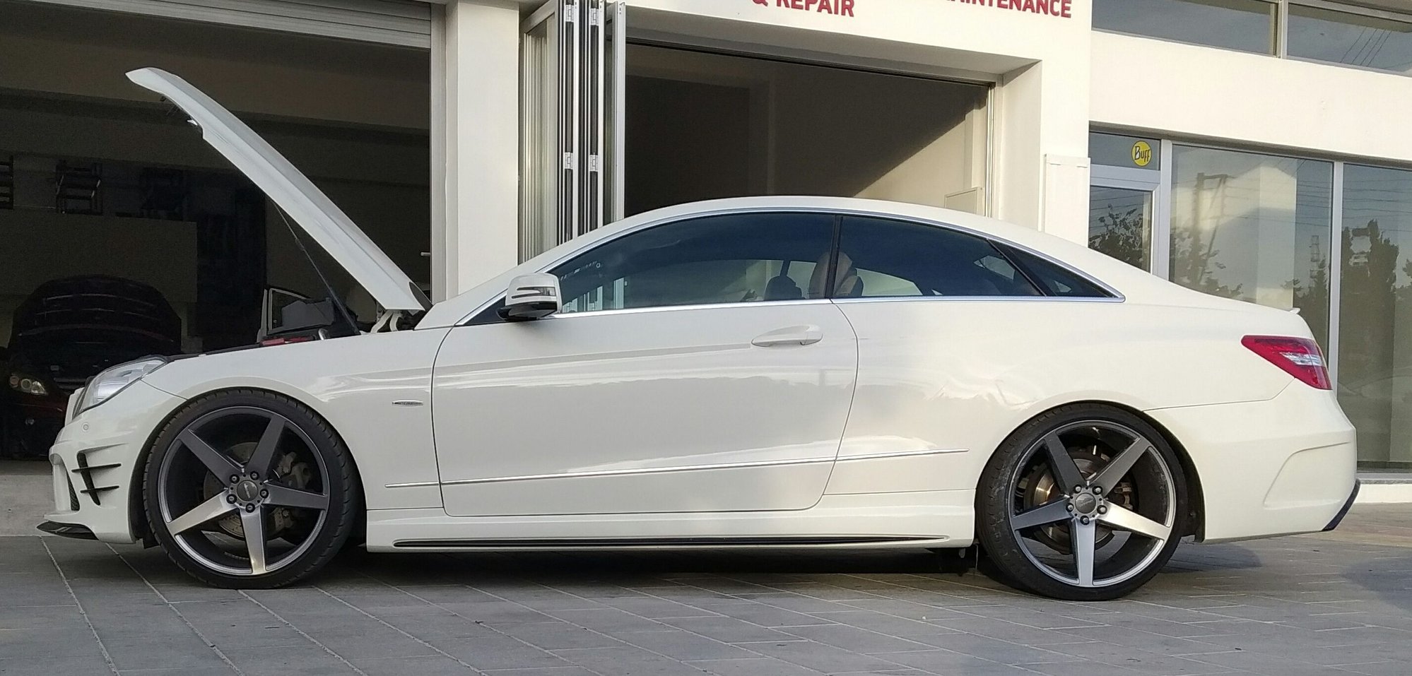

Finally installed
Hi all finally after so long I am on KW DDC with 20" inch wheels. Unfortunately I have a few rubbing problems on the rear when I hit a pump. I am planning to widen my rear fenders, has anyone done something similar?

Old Oct 3, 2019 | 06:11 PM
wtcnbrwndo4u's Avatar
Joined: Apr 2018
Posts: 8
C207 E550 Coupe
Looks great my dude!
