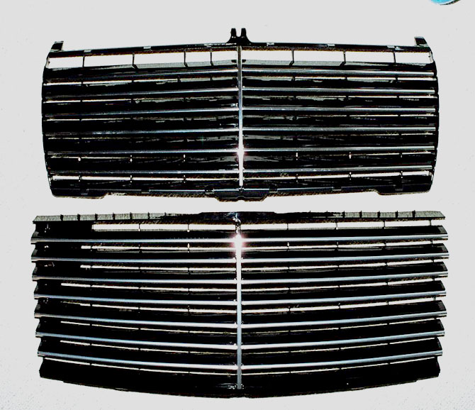

Essentially you have to loosen the two screws at the top right and left of the chrome frame first that connect it to the hood. Then take off the black rubber in the center up top. Loosening those two screws just mentioned allows you to bring the frame just foward enough to access that top middle screw which is connected to the emblem as well. Then there is the screw at the bottom of the grille to undo and the release screw. I had to just jimmy the grille around and pop it out and then back in again. That wasn't an exact science. Now there are a few type of grilles like you have there. I had gone through 2. The one like you see in that ebay link doesn't match the OEM clips and so I am not sure how it fits. To illustrate here is a pic i took of the differences. The bottom one is of a more brittle plastic whereas the top one is kinda flexible. I actually have to sell both because I didn't like the look with my color.
That top one matches oem to a T. The bottom one does not.

Aright guys, I just followed Zahkunst's instructions and it was done. Thanks man! Only thing you didn't mention was the metal clips holding the grill and also the trunk hatch that was in the way of the grill coming out. I had to remove the latch first, then jam it out...then squeeze the new grill back in..
Oh yeah, there was no opening for the latch to come out of the new grille so I have no more latch for now. I just have to reach deep in there with my fringers to open it. Haha. ALso looks more cleaner without the grey latch sticking out.
