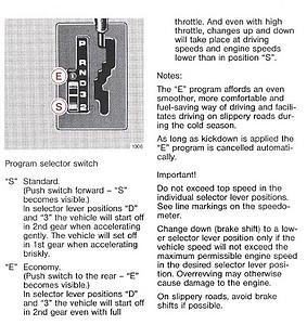

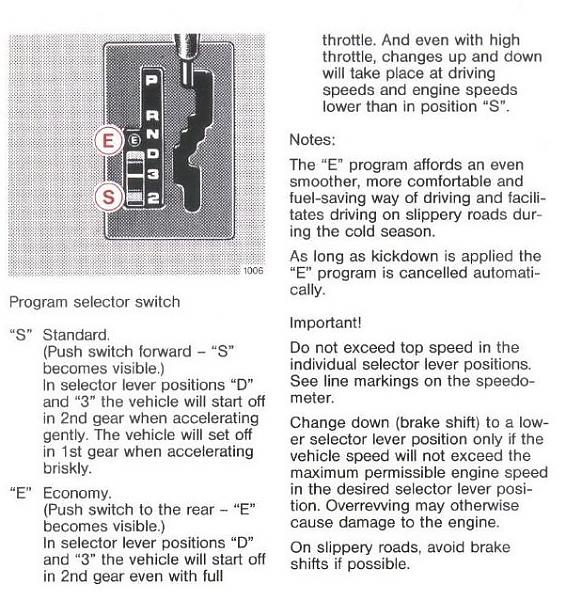

From the owner's manual:
Attached Thumbnails what, exactly, does the 's' for sport setting do?-722es.jpg

's' for standard - that figures, I've been thinking "sport" and maybe expecting a bit much...thanks for the info
