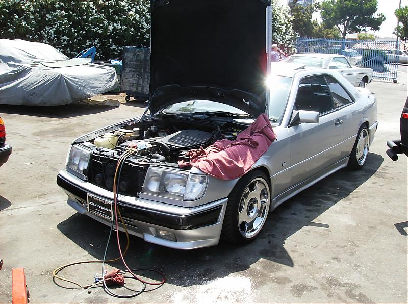

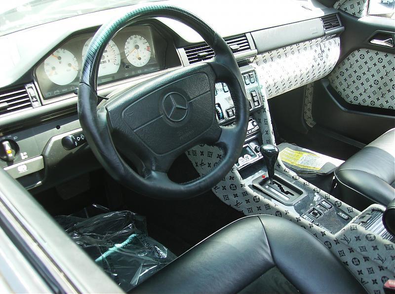

Because of the location of my Turbo the 300D diesel fender will work perfectly,But I need to spend a lot of time to make the driver side fender the same as I want a uniform look....But that is way down the line,I still have not been able to find the time to put it back on the dyno for final settings.
Do it--you car no longer is a stock car, and at this point you likely could care less about selling it at some point...
on a side note I finally realize why you are so impressed with H&R springs and sport bils...I have a silver coupe here that has just that suspension with shortest springs pads with 18x8 inch wheels all around and it travels the road just as smoothly as a stock suspension car and corners at least twice as good as my cab,so H&R are in my future maybe...
yeah I know the background is dirty as heck,but pay attention to the car...
Attached Thumbnails Turbo Hood Mod ????-ebay-sales-067.jpg   Turbo Hood Mod ????-ebay-sales-068.jpg
Old Aug 3, 2007 | 03:39 PM
  #35
JDW124's Avatar
Joined: Feb 2007
Posts: 214
Originally Posted by CoastLine
You car looks amazing already,Just please do both sides so it look uniform..
Oh my... That thing is so damn sexy :/. Liking the Louis interior .
Topic: RB, I think the vent would take some of the car's class away but I don't think your going towards to total hardcore luxury look anyways right? If steering towards the tuner/performance category the vent will look just fine imo
