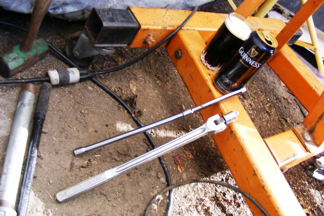

I bought an extension and was able to get them off. I didn't have a flex joint so I angled the bar on one of the bolts because of the pre-cat in the way. Luckily no rounding of the bolt head.

It is good to see from the picture that you got the most important tool when working on exhaust....a Pint of good brew.
