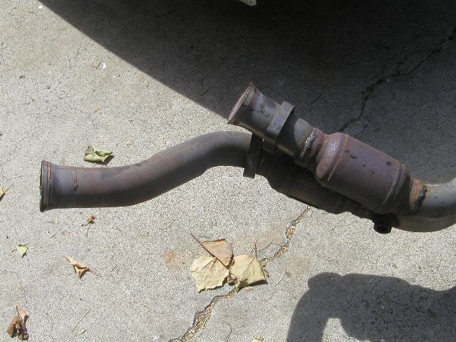

You know I "realized" I have a missfire on my white sedan but was ignoring it. It's definitely there at idle and the only nagging thing is it may affect my mileage suffers: 16-18 mpg. What are you getting? This car's head was professionally rebuilt but I had to fix the high idle and the hack things the shop did like add a helper spring and disconnect the ICV. They also screwed up the head thread for the water temp sender's and even left a Sharpie drawn arrow to it as if to remind them to fix it. They also left a water line loose that worked it's way toward the alternator pulley that eventually cut a leak. That's another reason for doing the work yourself, shops seem to cut corners at their convenience. It was done in another state so I couldn't go back to them.
I'd like to have my pre-cats removed, they are in the way of the manifold flange bolts and could improve performance. I don't see how an exhaust shop can accurately remove and replace them with a straight pipe while keeping them aligned. I had an '85 300E grey market import that had an aftermarket pair installed, see:
Attached Thumbnails 1988 300TE - Misfires - Part #2-p9080070-85-exhaust-c.jpg
I believe the best way (or at least how I had mine done) was to just have the precats hollowed out.
