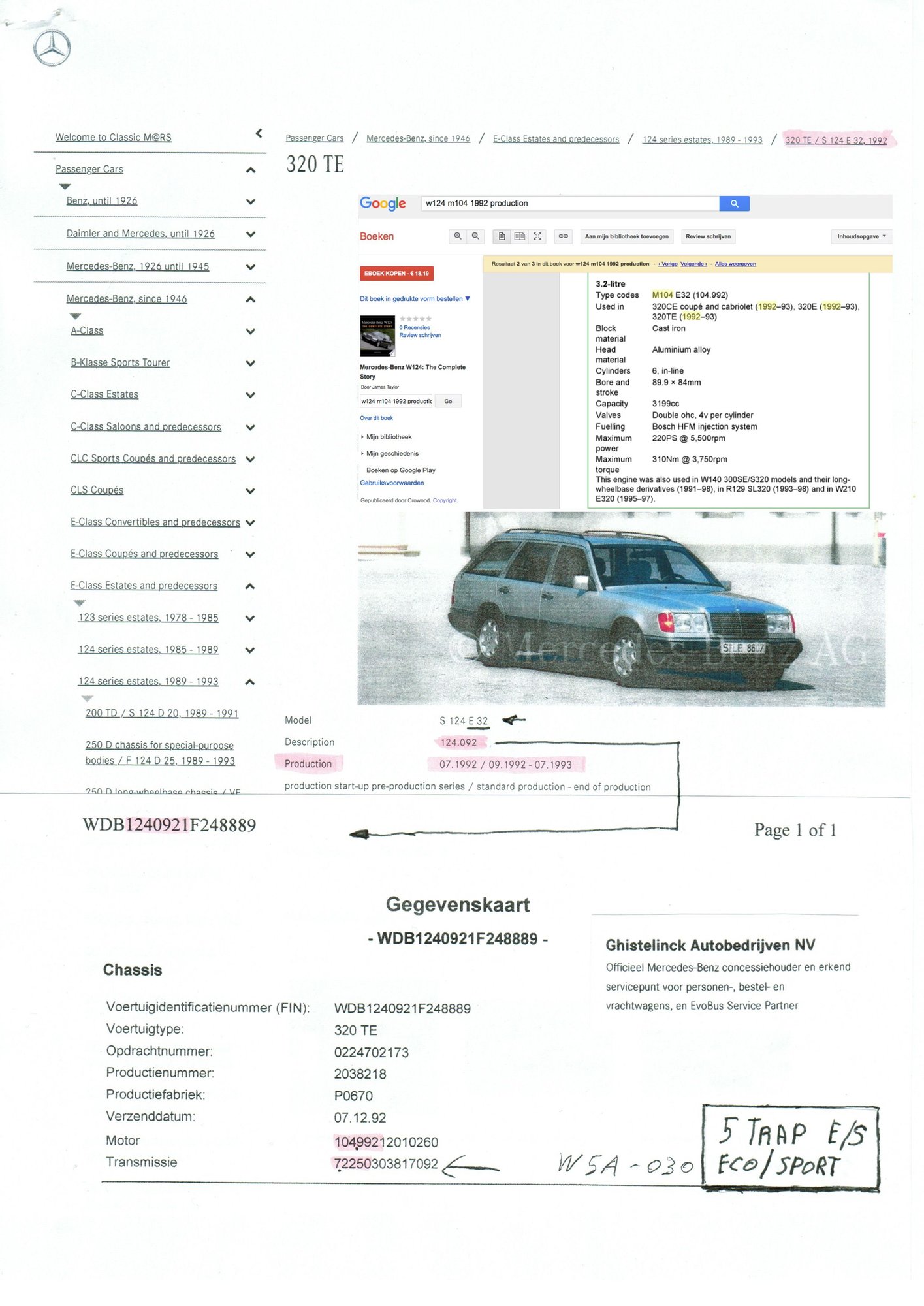

Its a hybrid model produced from 9-1992 to 7-1993

For this type, the easiest way is, you have to find a w202 as a donor, c280 (inline 6) 1996 and up with 722.6 transmission, the earlier model has one speed sensor on the rear which makes the conversion easier, thats what i suggest. You should get a complete donor car to make the job easier.
the rest you can read in this thread for more details.

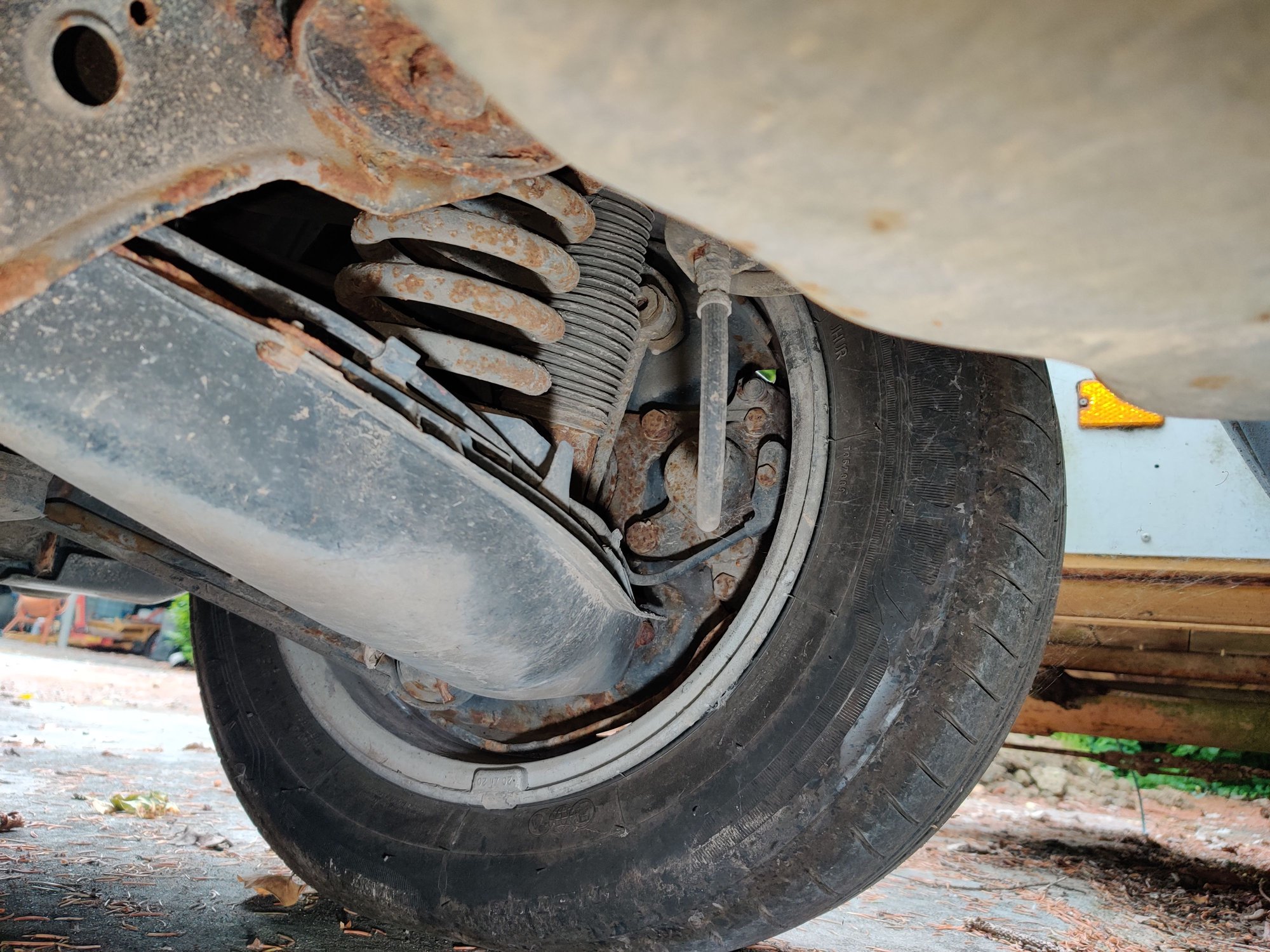

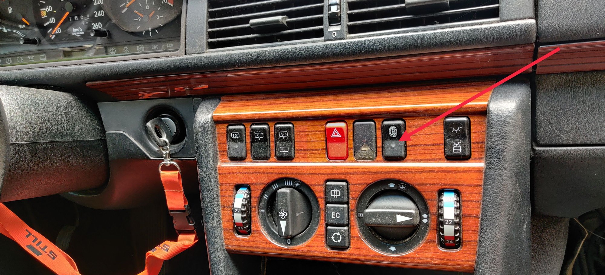

I did a quick check because i remembered that models with ASR also make a lot of difference compared to the other models....
Not sure what these sensors are ... they are both on my rear axles
Maybe it has something to do with this ? Is it lock-diff or what does it do ?

Yes thats ASR switch for older mercedes, for the pictures that you postes, i dont think thats the wheel speed sensor, i am quite sure that the brake pad sensor wires, speed sensor wouldnt be located there

Thats cable is going to the calipers, so im 100% sure thats brakepad sensor, and im pretty sure 96 and older mercedes only have 3 sensor including S class

Lock diff doesnt apply to sedan, lock diff only installed in G class
