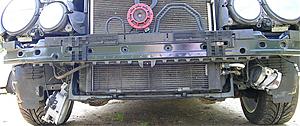

This is what it looks like with the bumper cover removed. The fog lamp on the LH on picture is held by a piece of wire so it won't hang from the harness. I figure by the length of your new harness you might be able to determine its location on the photo or where approximately it hooks up to.
Hope it helps.
Cheers

hey franasia - thanks for the pic! the bumper, in this picture, is hiding the end of the wire that plugs into...whatever it plugs into. if you have a shot of that same thing but from a birds-eye view, i bet we'd find that the wiring harness is tied down to the bumper and then re-routed back down to plug into a metal electrical box. i know that on the dirver's side it appeared to be the case with the temp sensor wires being taped together w/ the fog lamp wires. since i couldn't see where this join occurred, though, i can't say for sure.

I took a series of pictures of the front end when working on the horns last year. Sorry I do not have the view you want.
