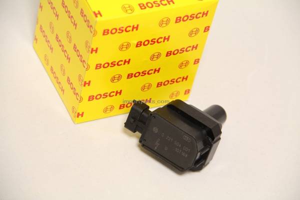

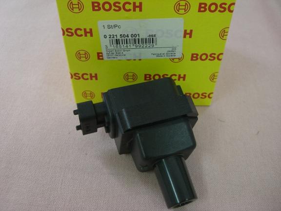

Don't go with cheap aftermarket coils,,
just get OEM or Bosch only...

i ordered this http://m.mister-auto.se/sv/tndspole-bosch-0300%20221%20504%20001_g689_a0300%20221%20504%2000 1.html
think its bosch
