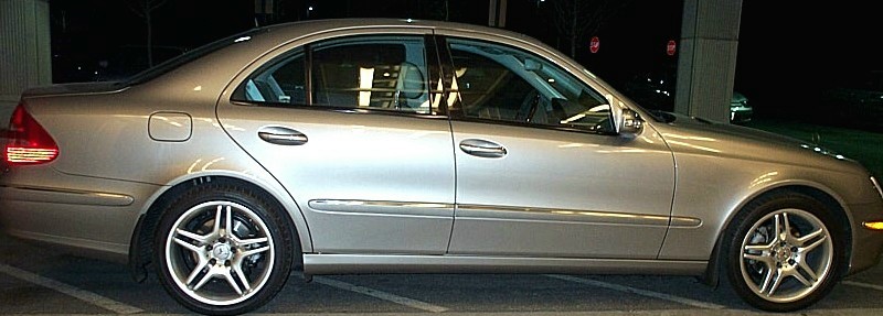

I would like to see some pictures of your car with that setup. Are you at the factory ride height? I’m thinking about going with almost the same setup but with 275 rears. I’m worried it will look odd on the CDI.

Will get pics. Car looks much better, I mean MUCH better, in my opinion.

Picture was chopped to fit MBWORLD size requirement
Attached Thumbnails E55 wheels/tires and still not enough traction off the line!-cdinight3.jpg

Thanks for the photo. If possible, post pictures from different angles this weekend in the daylight. It looks a little too high for my taste, but the photo is too dark to tell for sure.

Definitely looking to lower...the fender gap annoys me, its a tad too ghetto for my taste.
