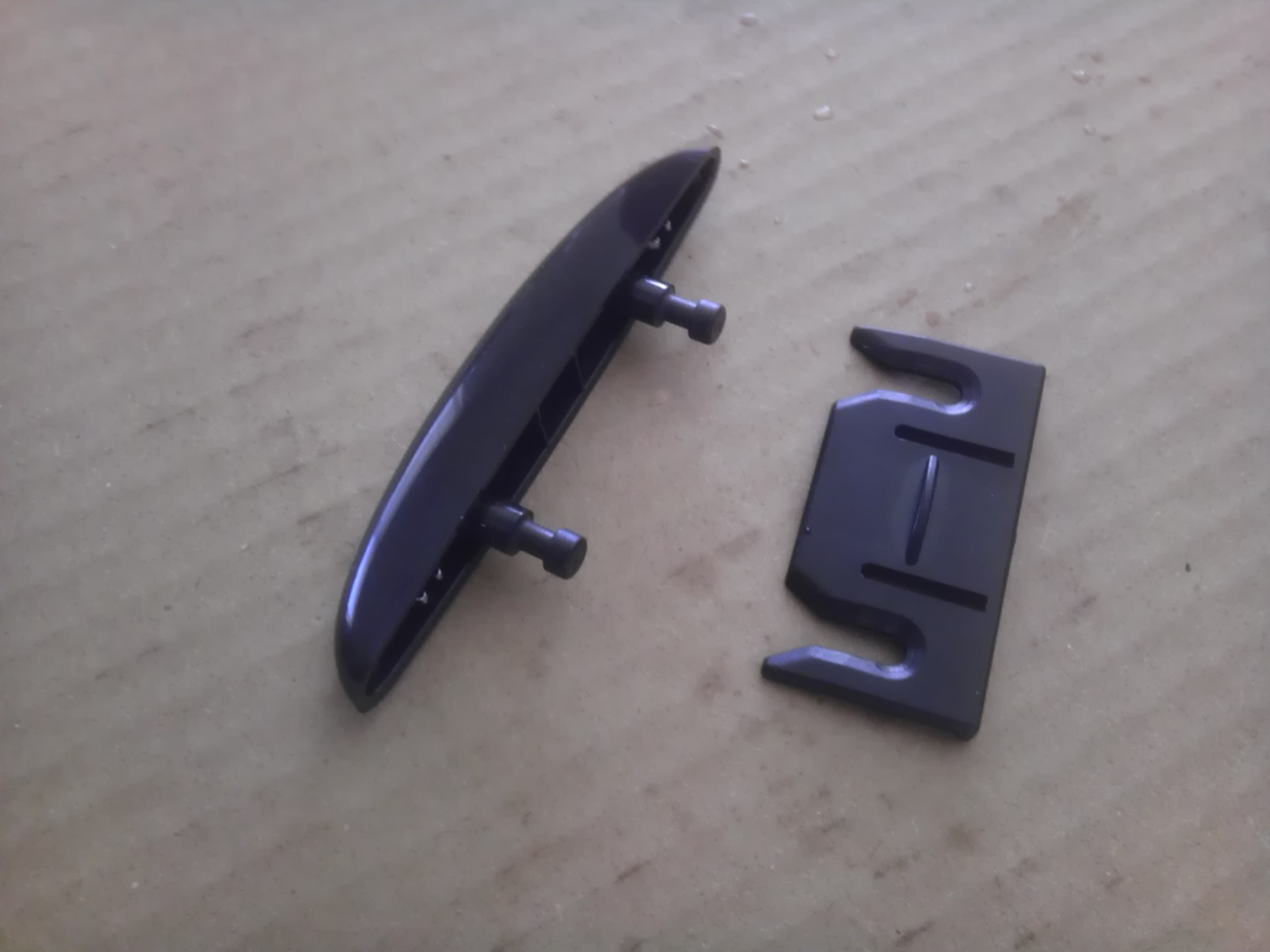

2116840070 - clip below if you need it. Mine was missing.
Around 20 bucks for both

So you did this yourself? Any tips on how to actually do it? I looked and could tell there was something underneath... couldn't really see it. Couldn't figure out how to get the handle off or if it actually did come off.

I didn't have the clip, so there was no problem getting the handle off.
The handle has two bars that go through the cover, and the clip has two gaps to accept the bars. Slide the clip in the opposite direction of the gaps.

Sweet! That picture is worth a thousand words. Thank you very much!
