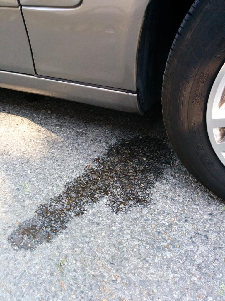

Windshield fluid tank repair
How do i get it out?

You remove the wheel and the wheelbay cover on the front passenger side and it is right there.

Don't ask why M-B designed it like this, but what you are seeing is normal. If you fill the tank too much, it will overflow. The trouble is that you can't see when it is full.
This puzzled me when it happen to me on a brand new E500 and the dealer told me that it is normal. My SL65 does the same thing.

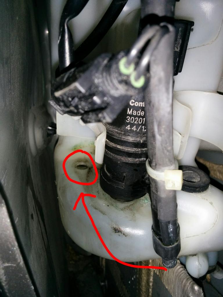

Ok, i fixed it. The rubber grommet fot the auxiliary hose went bad. Found some grommet pack at Auto Zone. Total repair cost $4.50 and 1 hour of work.
