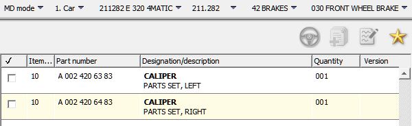

Hi all,
I've been trying to order new front brake callipers for my 2005 E320 4matic wagon, but when ordering there seems to be a lot of variants which is causing me some confusion. Are there really any difference between the different callipers?
It is to may understanding that all the E320's from this year have the same front brakes, but the websites all seem to indicate sedan and 4matic specific variants.
I don't want to have to go through various purchases and returns before I get the right ones.
Your help is appreciated.
Old Apr 19, 2015 | 11:17 AM
konigstiger's Avatar
Posts: 15,901
Likes: 4,632
From: North Scottsdale, AZ
'71 Pinto
Left part # 0024206383, right 0024206483 post or PM VIN if you want VIN confirmation for peace of mind. 4matic wagon (211.282) & sedan (211.082) caliper is the same however, non 4matic differs.

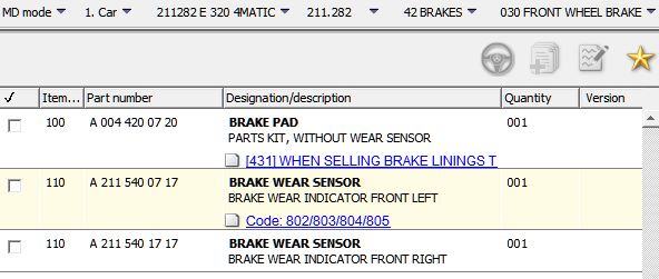

And I assume they use the dual pin oval plug wear sensors?
Thanks again
Old Apr 19, 2015 | 04:05 PM
Posts: 15,901
Likes: 4,632
'71 Pinto
Correct.
