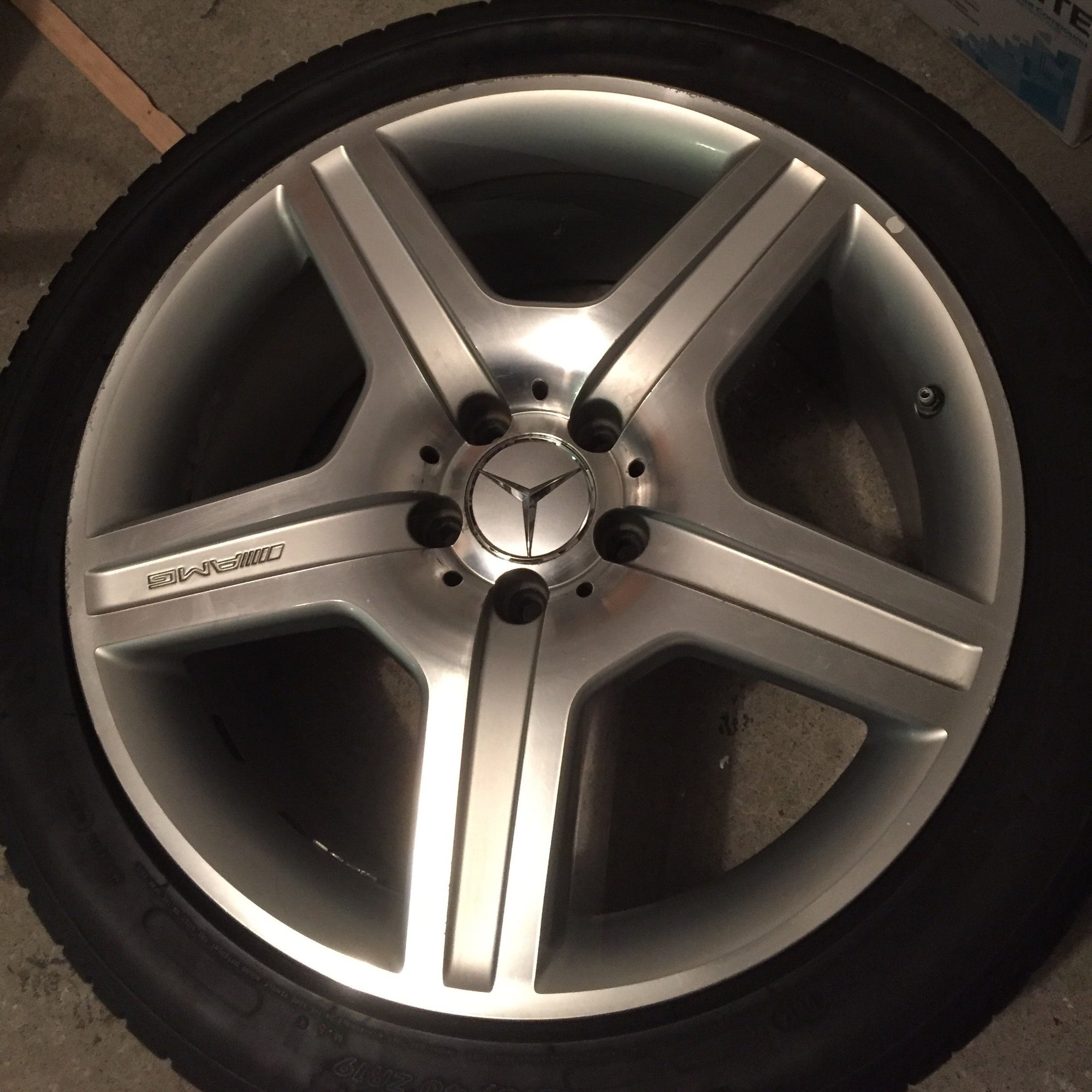

Hey guys, got a set of 19" AMG wheels that come on the S550 and now I'm shopping for tires.
Original size on these wheels is:
255/40/19 front - 8.5"
275/40/19 rear - 9.5"
Is that gonna fit on my e350 sport?
Am I better off with 245/40/19 front and 275/35/19 rear?
I'm planning to lower this car a bit. Also, offset on both these wheels is 43. A bit bigger than factory W211 wheels but I'll install and if I need a small spacer to have the wheel sit nice and flush ill go for it.
Here a pic of one of the wheels I got and the other pic is one I found on this forum of a member's car with these wheels on. His car isn't lowered.

I'm sorry but you lost me. Why would this set trigger any lights? There's plenty people here running CLS, CL, SL 19" with more aggressive offsets with no problems.
I haven't installed them on the car yet so I don't know how they sit .
the wheels came with the original bolts. Not sure what the difference is vs E class bolts, if any.
