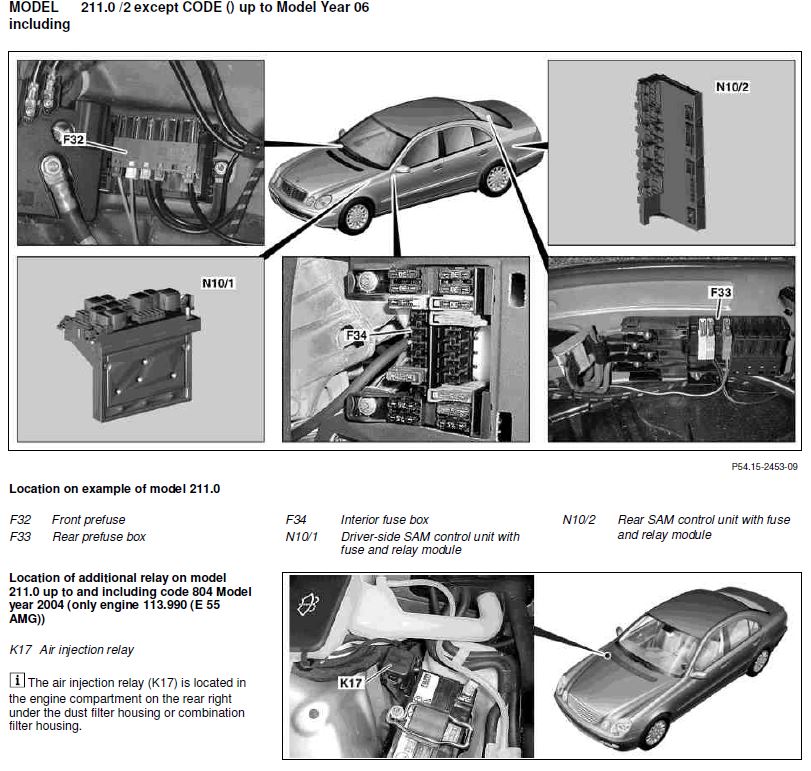

First step check "all" fuse locations for water.
Attached Thumbnails Washed my e350 and now NOTHING is working right!!! Please help-capture.jpg

I did a regular car wash, I checked and their is no sign of water by the fuses
