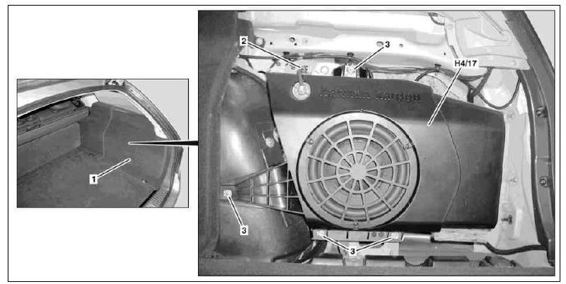

No leak at pump, open spare tire area if you see washer fluid there check plastic union fitting located above subwoofer and Sirius module (if equipped).
Yep, the connection right by the subwoofer was disconnected. Wonder if someone was in there doing something with that sub and needed that disconnected and forgot about it. Hope the rust doesn't cause too many issues. Thanks so much for your help.

Old thread, but...this info saved me tons of hassle. I had the same symptom and I popped off the rear panel and sure enough that fitting had separated-quick and easy fix thanks to this thread-cheers!
