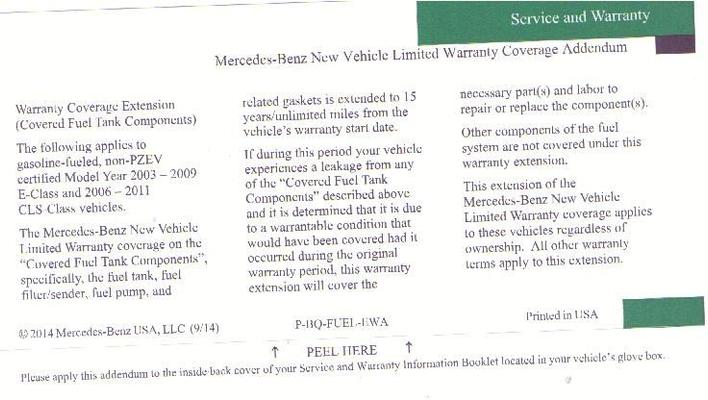

Again there is no recall. There was never a recall. In order to avoid a recall Mercedes extended the fuel tank warranty to 15 years and unlimited mileage. Your 04 is out of the extended warranty period. MBUSA will not reimburse for this repair.

2003-2009 non PZEV gasoline w211 tank assembly is covered by extended warranty to 15 years/unlimited mileage - 2004 e500 4matic mileage warranty has expired. “We bought the car brand new, and I have a 1" thick folder of service records from the original dealer, a secondary dealer (out of state) when the original went out of business, a local Mercedes-Trained Independent shop, and more recently the new local dealership that opened 2 years ago.” You can argue you were never notified by supporting claim with attachment but be prepared to answer if you ever complained about odor before warranty expiration.
File Type: pdf
