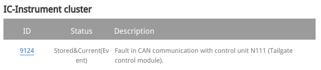

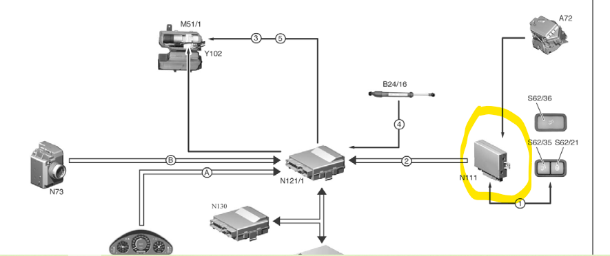

Hello,
I've CAN issues. The trunk N111 module is suspect. Where is the N111 module located? Thank you all much.

Originally Posted by Plutoe
I would look to the right side of tailgate--------or look here---Mercedes / Car > Mercedes EPC Online > nemigaparts.com
With your VIN I would love to know why you think you have a N111 module???
My scan rendered this N111 dtc specifically:
My trunk lid opens manually regardless of interior lock engaged.
And the below attached scan generally. Last year engine light turned on and fan at full speed. CAN issues galore. Scanner skipping over transmission. My attempts at a fix replaced front SAM, tested ECU, EIS with no effect. Replaced IC last week and new code litany rendered. Since the trunk lid has explicit problems, starting there seems reasonable.

Plutoe,
It dawned on me that my ebay replacement IC must be from an e500 estate. Same IC model, programmed for a lift hatch. Got it now.
Time to turn elsewhere...
