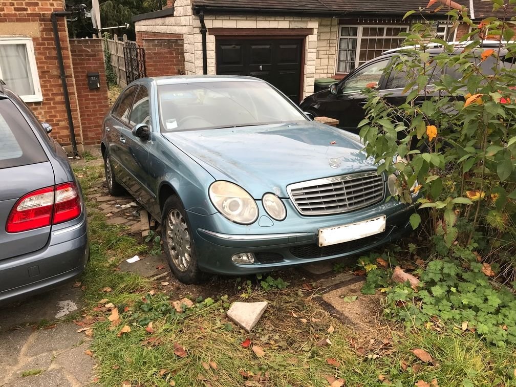

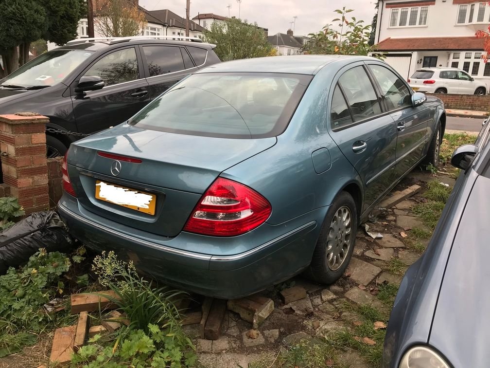

So as the tittle suggests, I am trying to get my dad 2003 W211 E200k started. It has been sitting for 10 years and it has pained me to see it like that. It was properly covered and only has 40k miles on the clock.

Added some pictures of the car, looks wonderful when she is clean.
