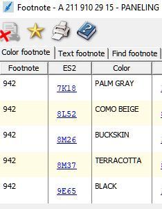

MB does not offer pocket separately, shop backrest panel part # 2119102915 used, 2119100591 new - see above for color code extension (i.e.: black 21191029159E65). If you're not sure of color, post VIN.
