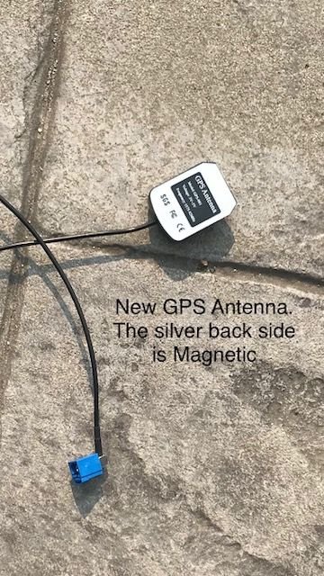

Parts for fix: You will need to buy 2 different GPS ANTENNA’s
Antenna 1: GPS Antenna Fakra C 5005 Bule SMB female right angle 3M cable ~ MFD2 RNS2 RNS-E (FOR GPS) (Purchased from E-bay)
Antenna 2: Wiclic Becker - GPS antenna Purchased from E-bay (To fix SOS Error)Make sure you buy these antenna’s, I purchased many others that didn’t work. Fix:

Step 4: You will want the(blue) Fakra GPS inside the car near the rear window area. Remove the subwoofer cover (snap on) in the back headrest area using a flathead screwdriver. Run the Fakra antenna from inside the car via the holes where the Subwoofer cover snaps into.
Step 5: Run the Fakra GPS along the side wall of the car and plug it into the back of the Navigation DVD tray.

Step 7: Connect the WICLIC Becker(black) GPS antenna to the SOS wire which was previously connected to the splitter.
Step 8: Run the WICLIC Becker GPS Antenna to the rear hatch clicking area which was previously covered by the hard plastic cover. The WICLICK Becker GPS antenna has a Magnet base which is fairly strong and it will easily attach to the area and stay firmly in place. This will stop the SOS Error because it now has a GPS connection again and the red lights will turn off also.
