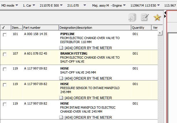

Good thinking. Won't cost you anything to test the other air pump. By any chance, would you happen to have the part numbers for the small vacuum hoses that connect the two valves?
211.070 (e500) which item(s)...

Can you let me know the part number for item 101, 107, & 119?
Old Sep 21, 2018 | 11:29 AM
konigstiger's Avatar
Posts: 15,901
Likes: 4,632
From: North Scottsdale, AZ
'71 Pinto
Old Sep 21, 2018 | 06:39 PM

Excellent! Much appreciated!
