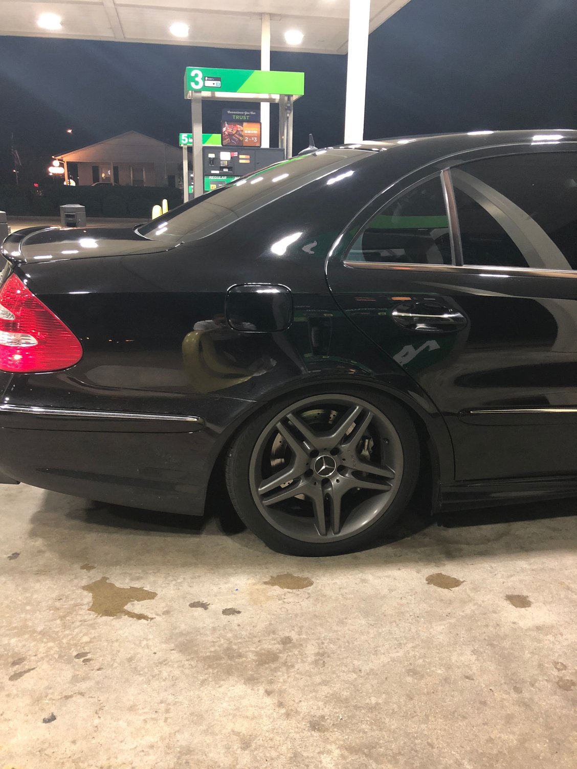

This is on my way home from trip when I first got the error.

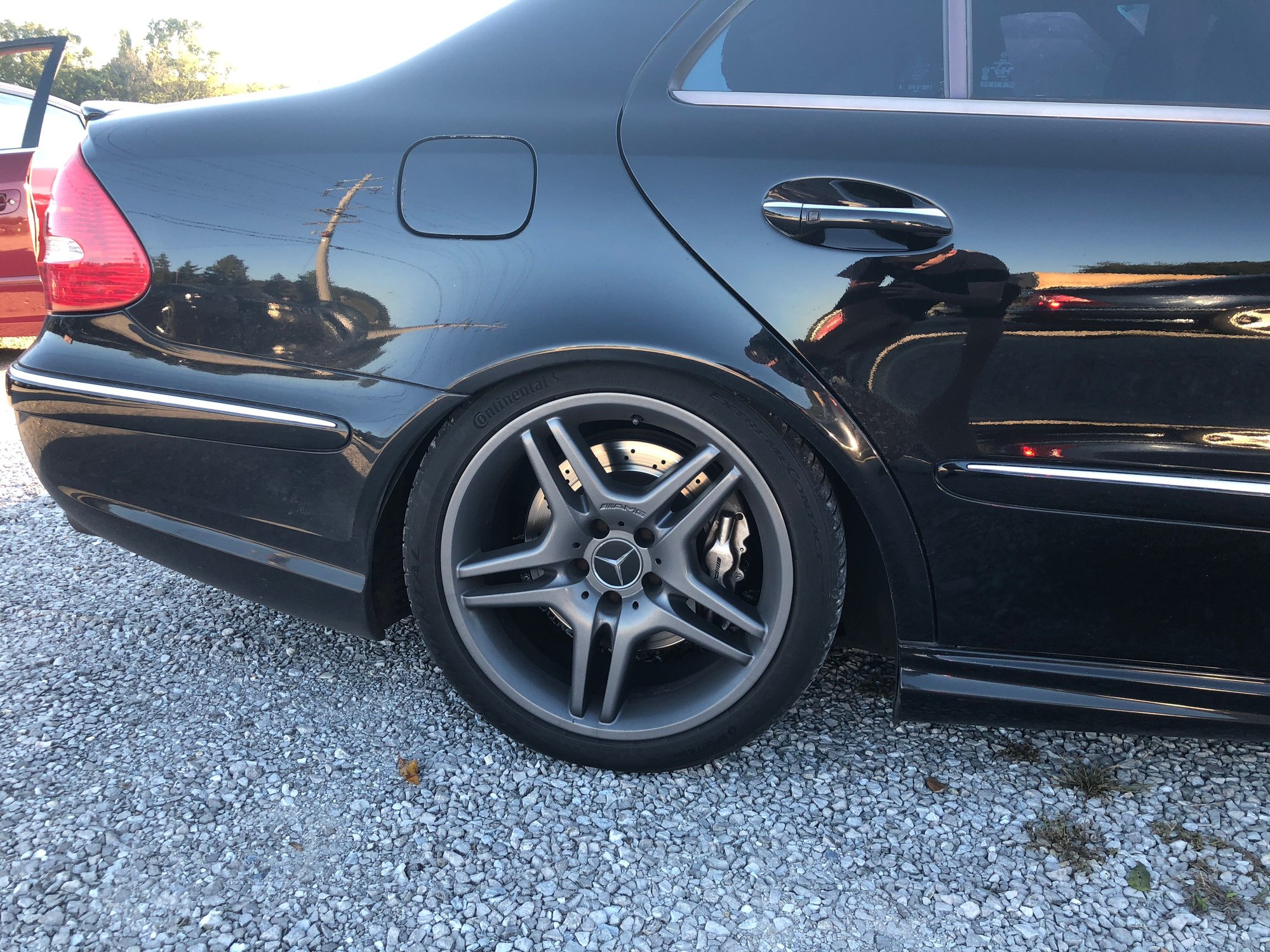

At the shop rear after sitting over night

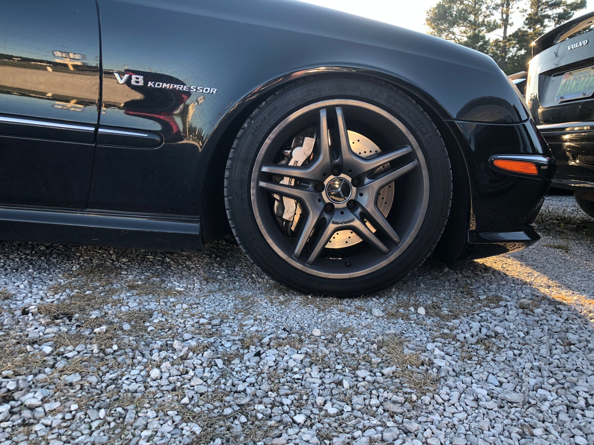

At the shop front after sitting overnight
