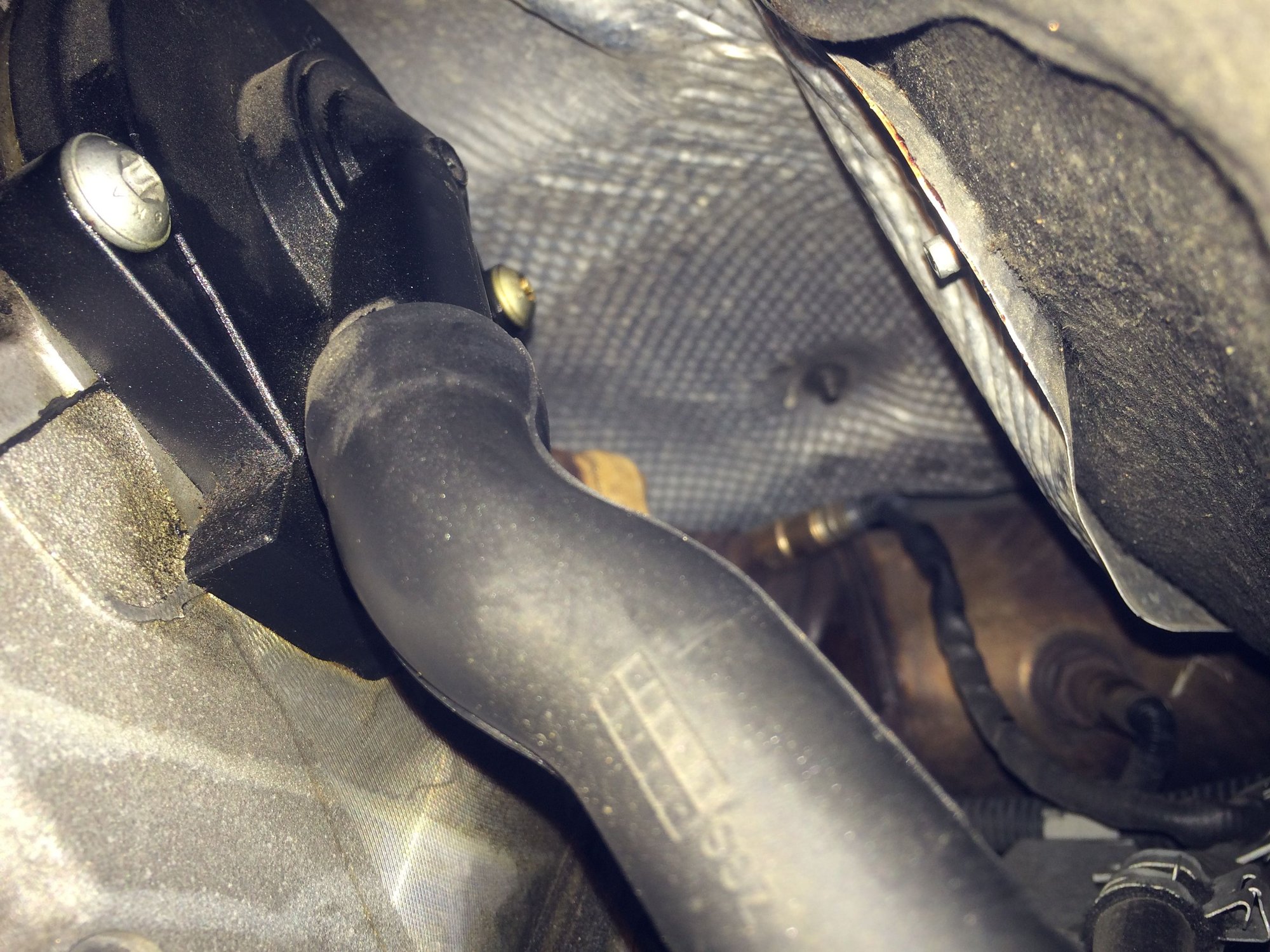

Minor leaking issue, trying to find what this part is. Located across from the fire wall by the #3 plus wire, has a breather hose connected to. Looks like a cam shaft cover. Anyone know what gasket or oil ring I need to order? See pictures.

Well if your hoses are ok, you probably just need this kit:
https://www.fcpeuro.com/products/mer...i-2720100631k2
Or if you need the hoses, this more complete kit:
https://www.fcpeuro.com/products/mer...kit-oem-515810
FCPeuro has a lifetime warranty on all parts so you shouldn't need to buy it again.

Thanks, was looking bit couldn’t pin point the part on FCP. Hose is fine, will order today.
