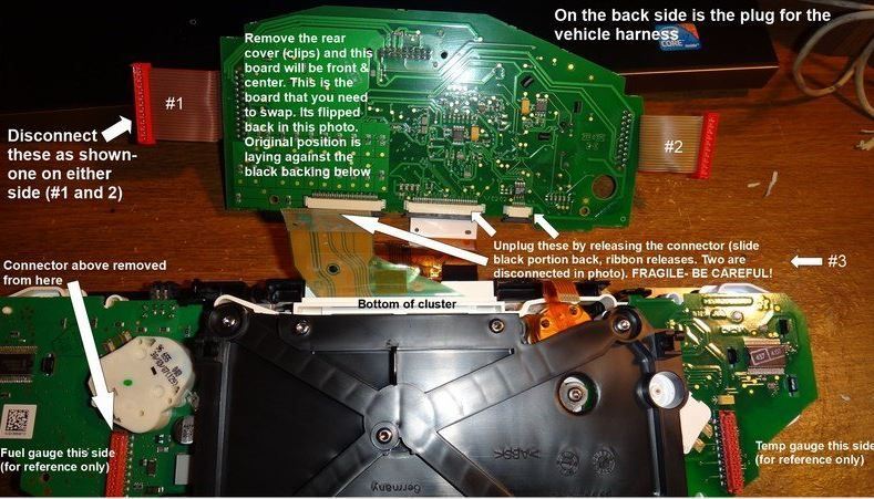

does anybody know if there’s a separate fuse for the engine management light or if the bulbs go bad?
I bought a w211 and didn’t notice that the engine management light wasn’t working, I think the guy who sold it to me has tampered with it so he didn’t have to do the repairs.
I’d light to fix the light it but not sure how to, anybody with any ideas?

05 e350 (Europe, correct?) no bulb, LED if not familiar with circuit board repair need to replace board from original (as shown) to replacement cluster to retain odometer mileage. Be very careful with ribbon cables. Here are compatible part #s to shop (06 e350 USA):
