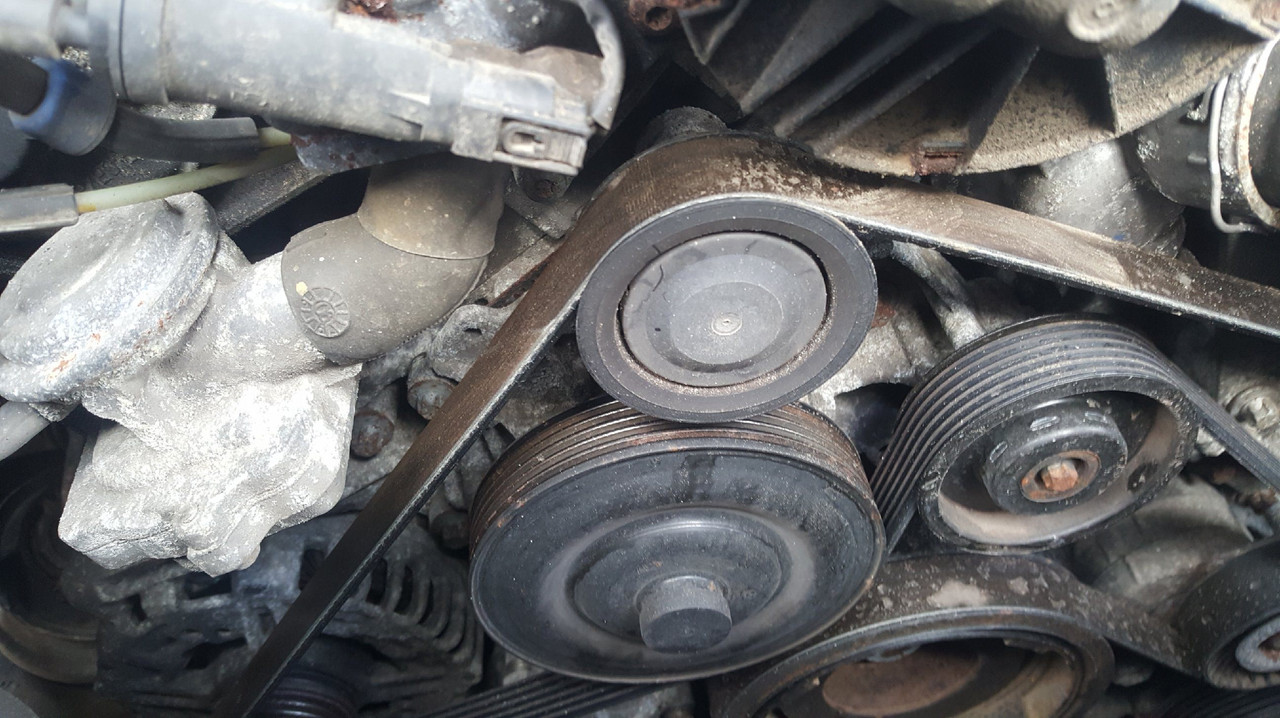

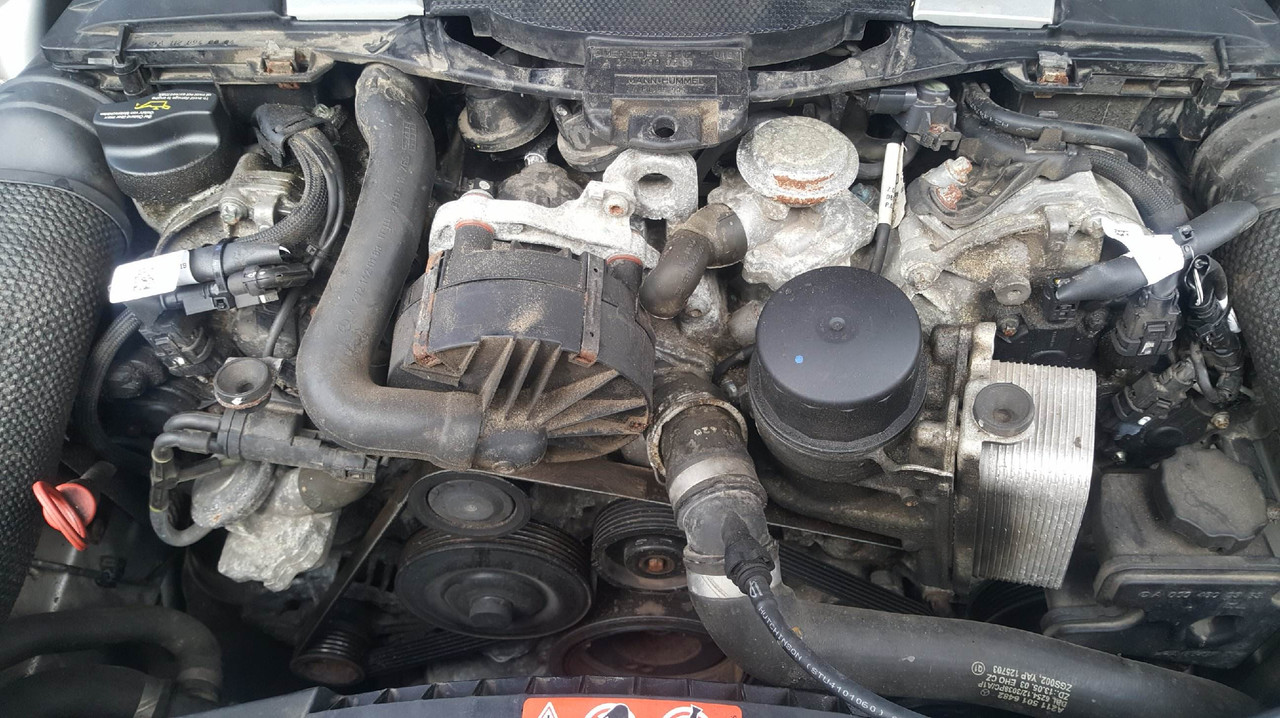

Issue and question - the seller inherited the car from a sick relative. The car sat completely unused in a heated garage for 5 years. This the reason for low mileage. It has never been driven in winter. Upon receiving car the seller brought it to an independent garage for full inspection and I assume fluid updates and fixes ( I will see all the invoices tomorrow). New battery and new front brakes were installed. The car has since been driven recently on one 140 mile trip with no incidence or warning lights. Garage have given clean bill of health.

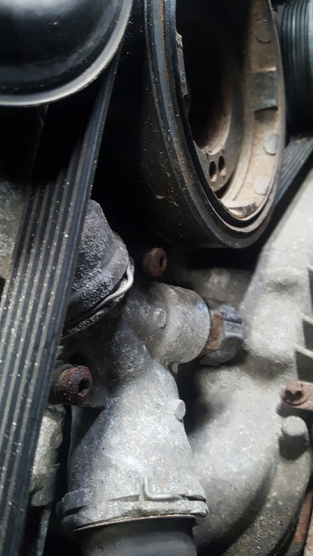

I asked seller to remove front engine cover and send me pics before I drive down. There seems to be a lot of calcium build up on the metals. A little bit of oil near oil filter but could just be normal wear for sitting so long.
1. Can you guys please look at the following engine bay pictures and tell me if you see any red flags? This is my first MB purchase. I do all my own mechanics and would like opinions from the other knowlegable DIY on here.
2. After sitting 5 years, what MB specific things should the garage have done?
Pics below and thank you so much in advance for any help. Cheers. John

Weeping from oil cooler seal I can see, cheap fix just a little time consuming.
since you can DIY yourself the ONLY thing I’d be checking is that it’s not within the bad balance shaft range. IF it is - walk away and forget about it.

The corrosion indicates that the car has NOT been in a heated garage, or the relative lived near by the ocean. Get the car on a lift or a ramp, and inspect it underneath. Take off the plastic guards, it is simply done with an 8mm snap on tool, with a short extension. Look for corrosion on all linkage in the suspension, most of them are aluminum. Furher look for corrosion on the aircon tubes, as well as the radiator. All these things can be expensive to change. Look for corrosion at the wheel arches, and underneath the car. These cars are prone to rust.

Yeah, the oil cooler was the only thing I noticed. But I would also probably do thermostat while doing oil cooler gaskets, both idler pulleys/tensioner and belt while doing that. Idler has to come off when doing thermostat anyway. Also check motor mounts.

My big issue right now is do the engine metals simply need a cleaning or is the condition indicative of more serious future problems. Am I looking at a cosmetic issue or something more serious?

Actually looks pretty decent considering it is a 12 yr old car. The minor oil cooler leak, as mentioned above, is easily fixed. The car is known to go through engine mounts quickly. I would imagine that the fluid filled rubber engine mount is well past it's prime. As it is fairly inexpensive and easy to replace, might as well do them. Don't forget the rubber transmission mount as well.
Tires have to be at least 5 years old if not older. While they may have a lot of tread life left, it is possible the rubber has gotten much harder. You might consider replacing these in the future.
Normally at this age, you'll start to have worn suspension components, especially in the front. I would wait until the parts start making noises or fail. Common components are the control arms (there are several up front), ball joints (upper and lower), sway bar links.
I wouldn't worry about the minor cosmetic rusting of the engine parts. Those parts look normal for the age. The rust looks like surface rust (easily removed if needed). Honestly it looks like the engine needs a good cleaning and that's it. How is the interior? I would be worried about some mold growth if the car sat there for a long time.
Another thing that is often overlooked is the rear differential fluid. I would recommend a drain and refill as soon as you can.

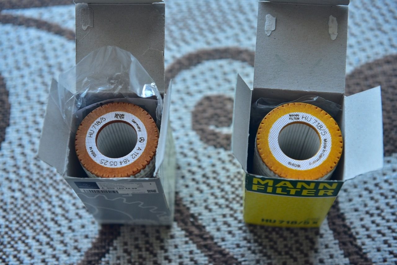

2. OEM parts - Dealership or are there better sources. I.e. I see that Mann filters can be sold without the MB logo. Is there a main place all you guys shop and source stuff?

As for parts, I like FCPEuro because they have a lifetime warranty. Having said that, there are other vendors as well. ECSTuning, AutohausAZ, RockAuto, Amazon. You are correct, Mann filters are one of the OEM suppliers for MB. For example, their oil filter for M112 engine would be HU718/5x. As you can see in the photo, the only thing missing is the MB Star logo printed on the filter. In this example, be sure to use the HU718/5x fleece filter. It is white. Do not use HU718/4x paper filter. It is not the same and may cause a leak around the filter housing. I am not familiar with the specific engine oil filter for the 3.5l v6 so you might want to confirm with various sources for the correct filter.
Mercedes filter and Mann filter

For parts I mostly use fcpeuro, but sometimes I shop around depending on the part. For instance rockauto has the kit for the tensioner/idler pulleys and belt. FCPeuro has it for a little bit more. Not sure if I'd really need the lifetime warranty on those parts. For brakes though, you'd be hard pressed to find someone else giving you a lifetime warranty on rotors and pads. I just get the Mann filters from Rockauto although you can also get them from fcpeuro and have a lifetime warranty. I just don't want to abuse them that badly.

Also check the back of the engine for oil leaks from the crankcase vent valve. If you had a scanner, I'd tell you to use one that can check for MB specific codes.

I wouldnt worry at all about that to be honest. And I disagree with the above poster about not being in a heated garage. One cannot tell that from the oxidization present. Heated garages dont keep humidity in check when heat isnt needed... Balance shafts are the number one concern IMO, and since you are outside of that range and do your on work, give it a go if its priced right.
As the others have mentioned, motor/trans mounts, suspension components (ball joints, bushings, etc) are the common issues that seem to appear.

Rock Auto also carries those Mann filters at a good price, and yes, Mann is the OE for M-B. Mahle and Hengst (both also made in Germany) apparently are also OE's for this filter; I've also used them with good success. Actually, if you know what you're looking for, Rock Auto often carries the actual OE part and can save some bucks.
Other places I shop: I typically buy from either MBOemParts.com (Mercedes-Benz of Naperville, IL), OEMercedesBenzParts.com, and FCPEuro. The former two, actual dealerships, give nice discounts for online orders. The latter is already well known for their good service as well. All three have gotten plenty of money from me. :-)
