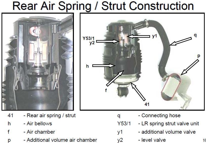

Sounds like internal valve is at fault.

My 2004 E55 with almost 132K miles, leaks down at the left rear also, but usually takes a week or more to totally bottom. When parked in comfort mode, it doesn't drop for 3-4 days, then the more it drops, the faster it drops, until bottomed out. Also, both left and right sides have bottomed out with longer time parked, (2 weeks). Like you, if I park it in raised mode, it seems OK. My theory is that the air bellows, ( inside the air spring assembly), are leaking at the fold, and the farther they drop, the more they leak. In raised mode, the fold in the bellows is pulled straight, and they seal, at the wear area, and don't leak. Mine raises back up without the pump running, and no dash warning. Either way, valve, or bellows failure, will require replacement of the air spring. I'm more nervous about the front struts failing suddenly, even though they never leak down.
