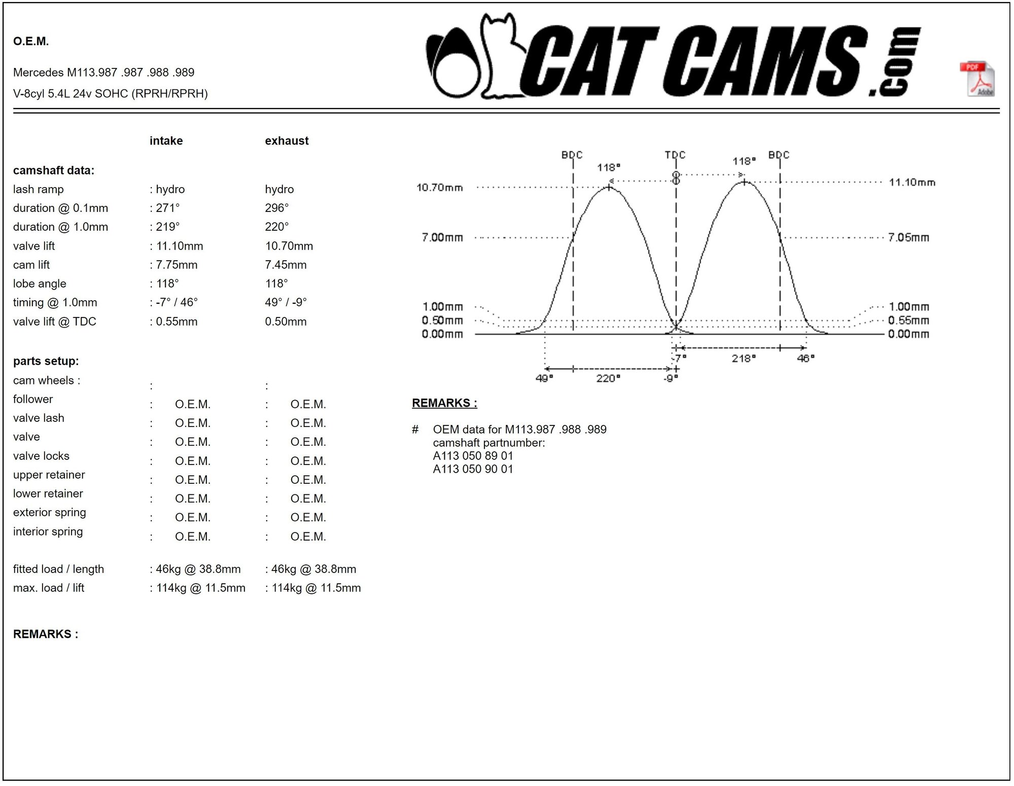

There are 100% differences in the camshafts, We have scanned every OEM version of cam.
You can SEE the lobe difference in your first picture,
Old Mar 25, 2021 | 12:04 AM

Hi MB World,
I posted this in the SLK World and wanted to share here what I found.
After extensive searching, I believe I have FINALLY found the exact engine codes for our engines as well as its stock camshaft specs!
If anyone can confirm this, let us know. I think this is good info if you want to do a heads / cam upgrade and are wondering what the stock cam specs are.
These 2 websites have the info:
This website has the Engine Codes:
http://portal.enginedesk.net/models/..._10_ltr/MER4_D
This one has the Stock Cam Specs:
http://www.catcams.com/products/camshafts.aspx
I've attached an example of the OEM cams doc on cat cams website for my R171 SLK55 AMG as an example
Enjoy!

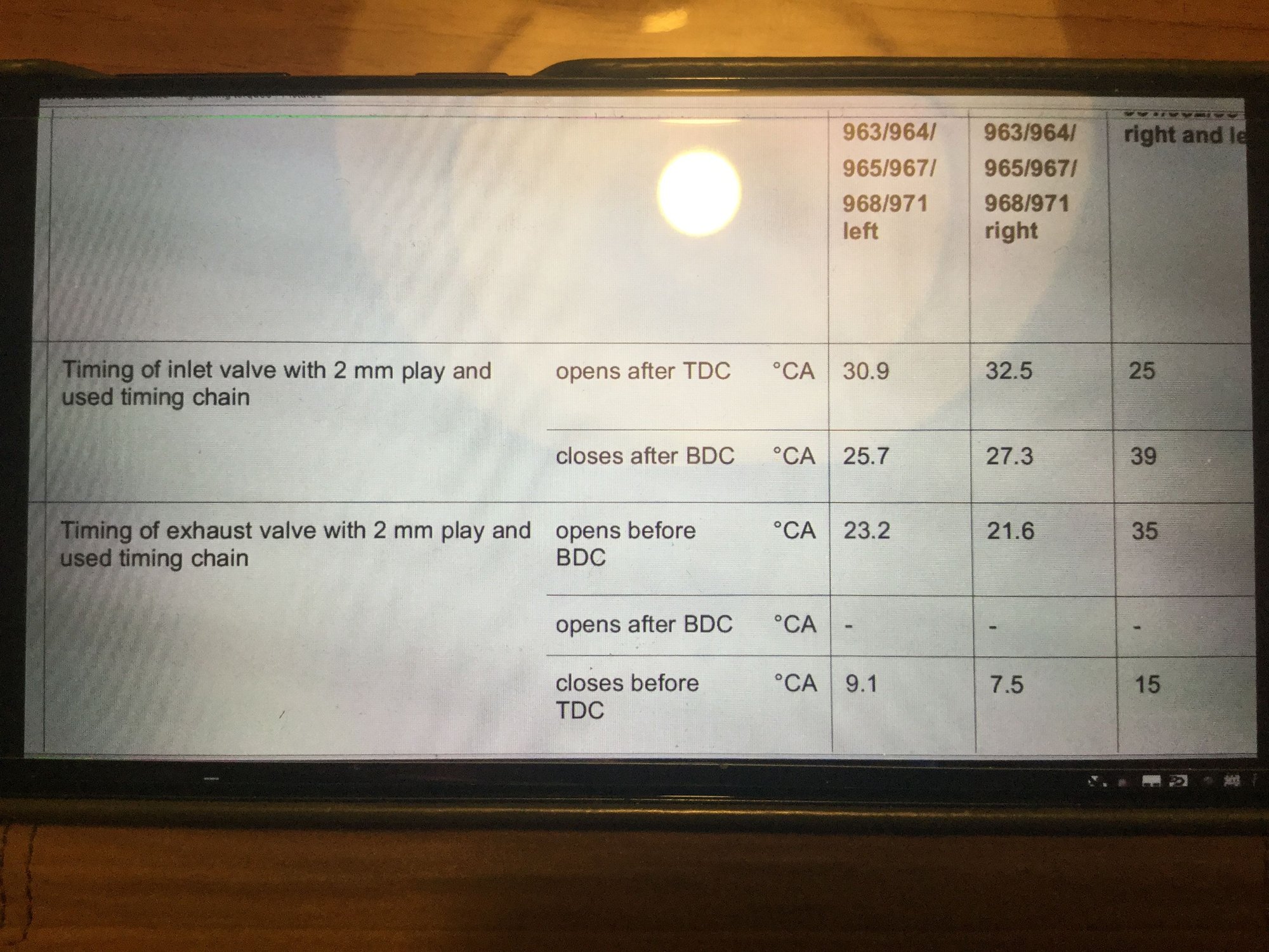

Am I right that the M113.989 engine has cams that are more effective in the higher rpms, ergo less torque at low rpm? (Max at 4000rpm)
If I wanted low end torque, best engine would be the ML AMG version, 113.981 I think?
What I do not understand is, why thIs 981 version has 347 hp and max torque @2800 rpm, vs 360 hp and max torque at 4000 rpm for the 986, while cams, valves heads are the same according to EPC.
MOST REMARKABLE; according to STAR, the standard 5.0 , 306 hp engine, has different timing for lhd cam and rhd cam!
Something I can not conclude from the Cat Cam information though.
Can anyone shine a light on this?

Specs timing 306 hp 5.0 M113

What are you trying to achieve? Make e55 made 375wtq at 2500rpm, it makes over 365wtq got like 3500rpm.
I wouldn’t be two concerned about the rpm difference between the e55 and the ml55. In reality it’s a very small difference on a dyno.
I was planning on installing a set of cat cams, and Moscow headers but sold my car. I am guessing with the cams, and headers it was going to make 390 to 410whp, and 420tq
