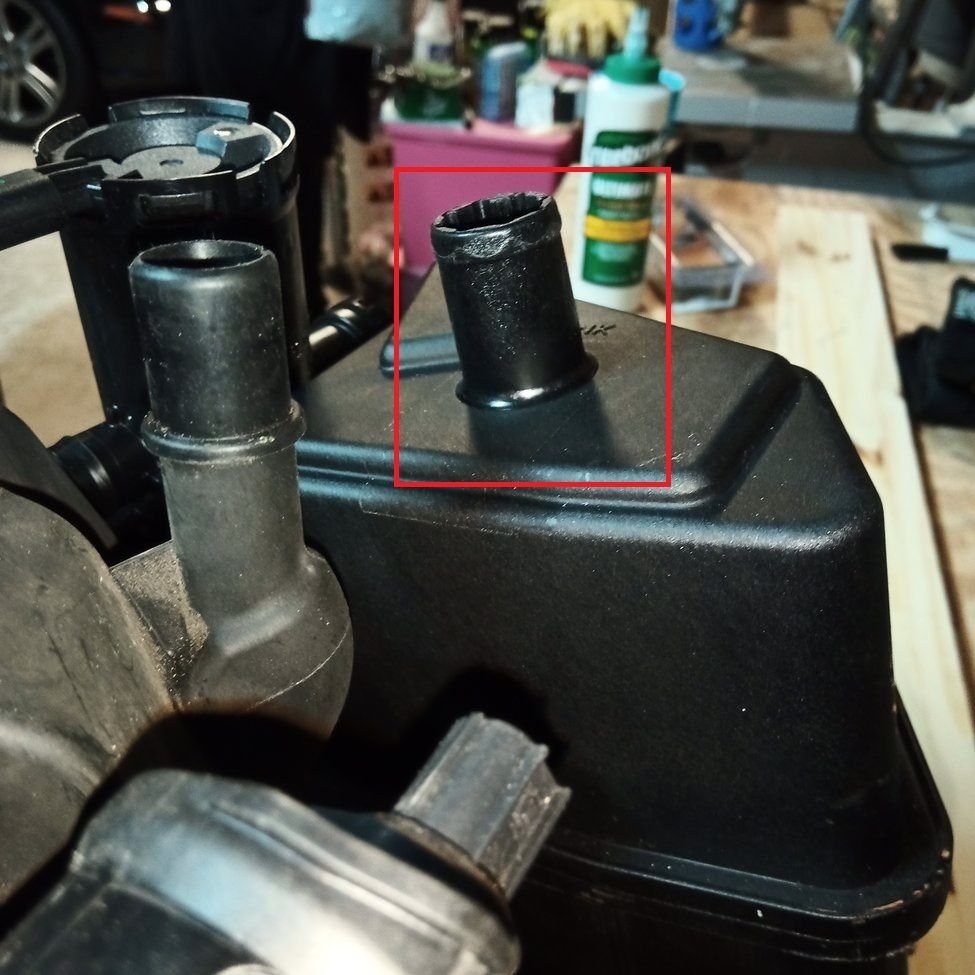

The canister I ended up getting was a 211-470-01-59, which I think is for a newer model W211 with a different connector than the one my 2004 has for the hose to the fuel filler neck assembly. Is that connector and hose have a part number that I can order without buying an entire filler neck assembly? The adapter that I cobbled together from the old canister and some hoses/clamps just isn't a permanent fix and I keep getting the red warning that my fuel cap isn't on when it is on. The pics below show a generic filler neck with the hose/connector circled in red. The other pic shows the old and new canisters with the new canister connection point in the red square.

Put your VIN in here :
https://mercedes.7zap.com/en/eu/fg/car/

Oh snap! I didn't know that existed. Thanks!
