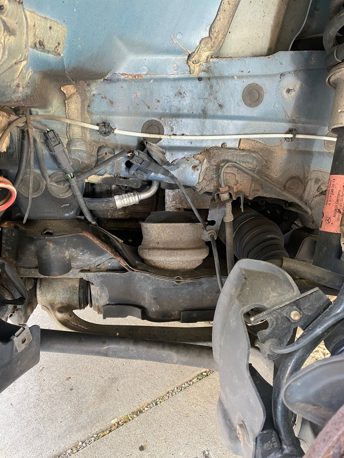

So I finally did this job on my car. Just as OP and everyone else has said, it's easy peasy (on a W211 4matic with the M272 engine). Put the car on jack stands, loosen the top and bottom bolts on the mounts, remove wheel and fender liner, jack up the engine with a piece of wood a few inches, and the mount can be pulled out and replaced. I was surprised at how much I had to jack up the engine to place the new mount. My original mounts were badly collapsed and I think the originals with 231k miles on them. I'll post pics in a separate thread if I can ever get time to.
