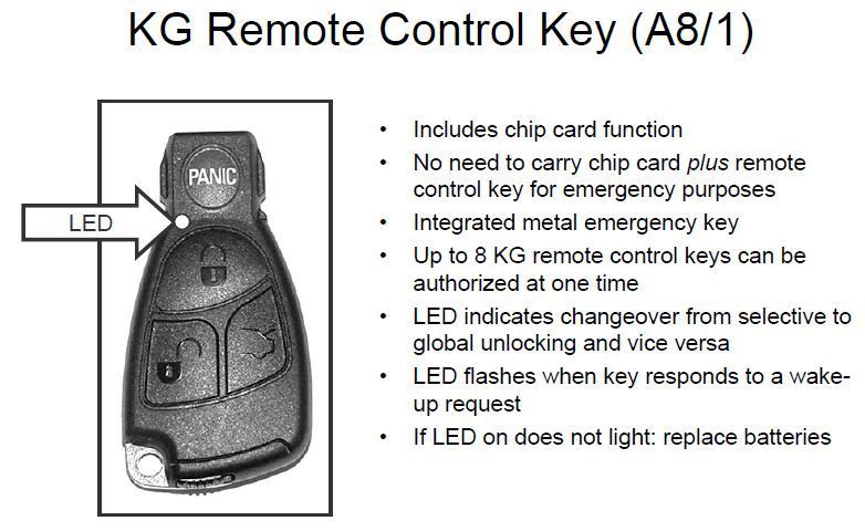

No card, only fob, first step:
See attachment to get an understanding of system. If KG key, best to have someone pull fault codes before replacing part(s).

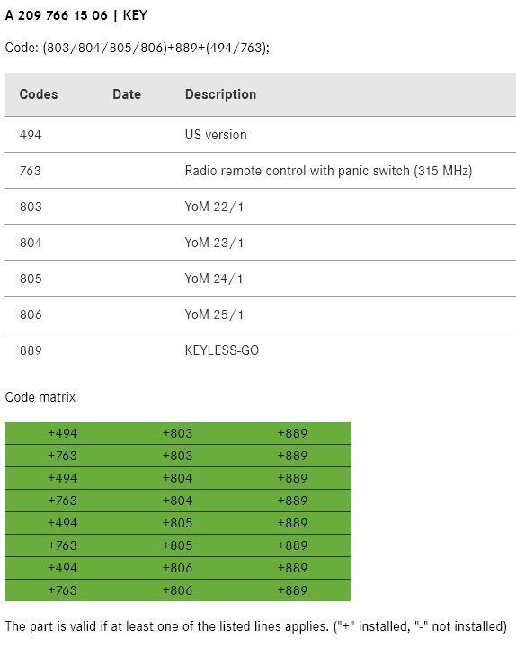

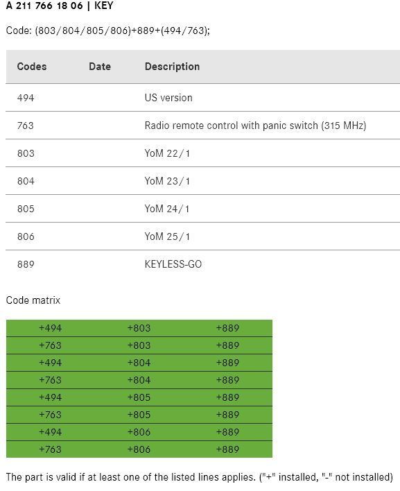

Original is no longer available but compatible/programmable replacement should be available EPC shows: 2117661806 up to VIN A248086, 2097661506 from A248087.

This is perfect. I'll be able to order the exact part at the dealer. My car is has these codes: +494 +803 +889.
