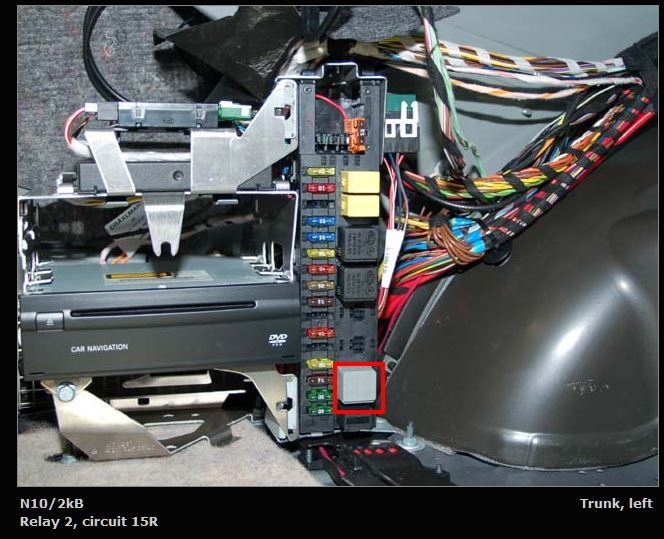

Relay B in the trunk is clicking like mad. Not at all helpfully it is designated as the "Relay 2, terminal 15R" relay. I pulled it out and so far everything still functions. What's up with that? Anyone know what it does?

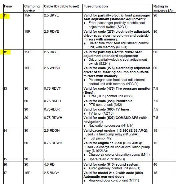

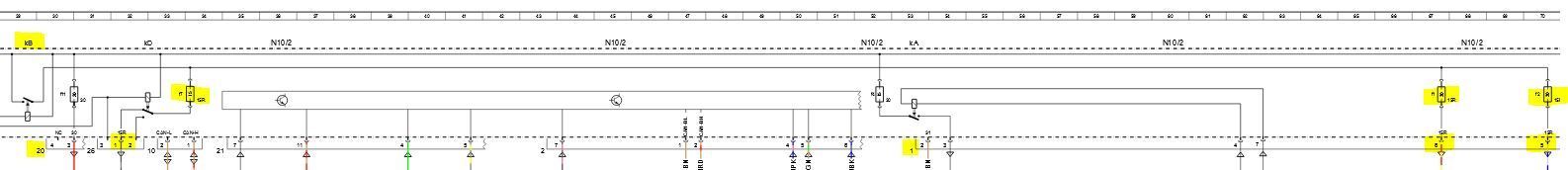

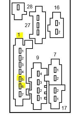

Wiring diagram shows f1 / rear SAM connector 1, pin 5; f2 / 1, 6; f7 20 / 1-2 (wagon).
Very interesting. Hmm all of my power seat stuff still works fine with those relays pulled. Strange.
