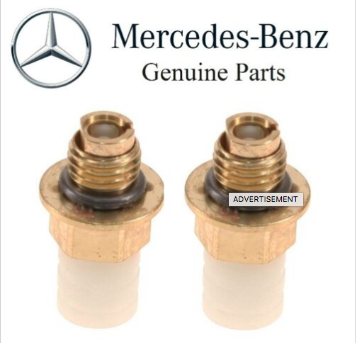

Left rear has been at times a bit low since I bought the '03 E500 last year. Today I found the leak...the connector on the compressor that leads to the valve block. Gently tightened the fitting made it worse. Now it's really leaking. What to do? Is there official MB fix available at dealer parts?
Better yet, is there an unofficial fix someone can recommend until I get back across the border into San Diego?

Tightening it was likely a bad move, as you may have stripped the threads in the compressor housing. The connector needs to be no more than finger tight + a smidge. If you remove the brass connector you should see a o-ring which seals it to the compresor housing. The other o-ring, seals the air line passing thru.
Also, for that to be cause of your left rear dropping... means the valve body is suspect. Either one or multiple solenoids are stuck open OR there's an electrical fault causing that solenoid to stay open.

Roger that. Was able to find another 'O' ring and stopped the leak. Mine has only one 'O' ring unless you refer to the brass compression fitting that sits on the line between the voss and female compressor end. Headed to civilization to pick up a replacement voss, filter, and compressor rebuild kit.

I trust you have a scanner. The fitting is a Voss #4 male connector that is the only white nylon line exiting the compressor going to the valve block. These connectors are used throughout the system. See attached. The male fitting is brass, the female on the compressor itself is plastic.
The LR has always been low. At the point the LR sank too far, I soapy tested all lines, tanks, connections, bags, ad nauseum, and found the leaking fitting. It threw a code. The female section was stripped. Horrible design.
I was able to secure a new brass fitting and O ring, I installed it. It still leaked. It soon popped out. The car went flat. Permatex/Locktite 242'd it. Pinned it secure. Cured it overnight. Code erased. Stopped leak. The car raises and holds.
