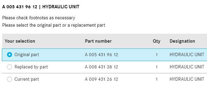

Hello, I need to replace my SBC control unit and I have a replacement unit however its OEM number is a little different, in my mercedes right now I have "A 005 431 96 12" which is faulty, and I want to replace it with "A 005 431 38 12"
Where can I check if there will be a problem with fitting them?

mbepc.net

Thank you so much, very helpful site!

No VIN, compatible part #s:
