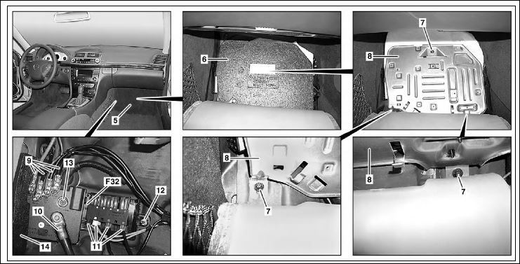

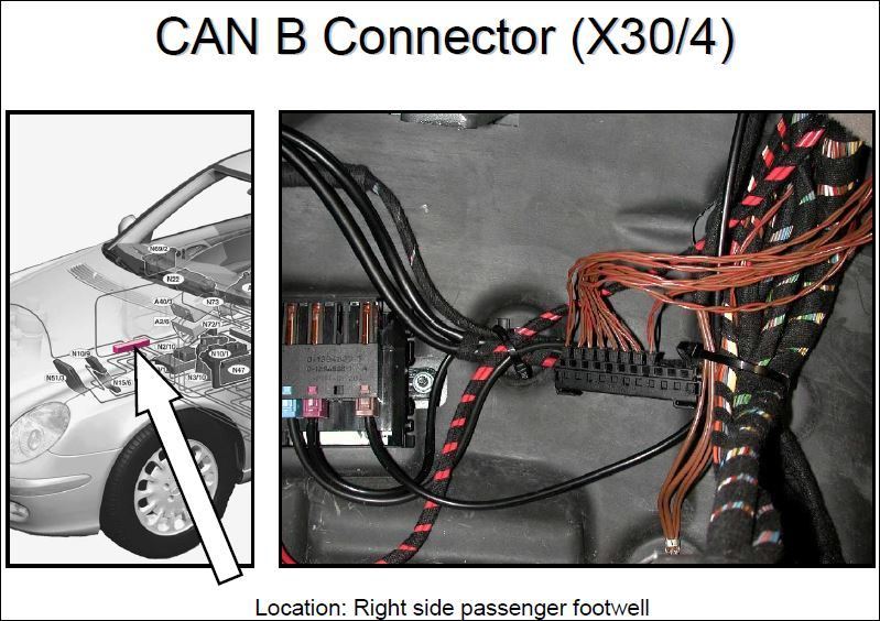

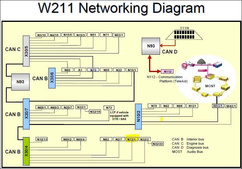

First check x30/4 condition if fine move on to UCP.

Many thanks for the detailed reply, I'm presuming for a right-hand drive it will be in the left footwell?
