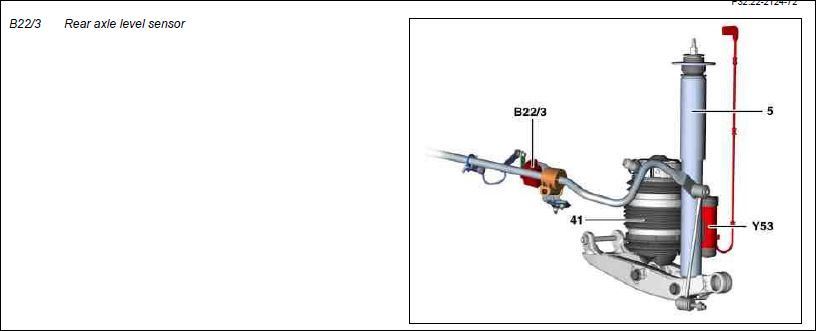

By any chance did you disconnect/bend/rotate the level sensor attached to the rear sway bar? That's usually the issue. The air valves opened to inflate the springs so that reduces the chance they are bad. One maybe, but both? Unlikely so I would check the level sensor. Be advised, however, you may need to recalibrate the suspension; I had to do so when I converted from OEM to Arnott springs.

The rear sway bar linkage was the part that was enormously difficult for me to reconnect on the second side. I did not see a sensor. Where is it?
I saw a curved black-painted bar (please correct me if this is not the sway bar) that on the car side disappears into a thick rubber bushing and on the wheel side connects to suspension links.
Disconnecting the main battery for an hour did not change anything. The car still holds its level, relatively low in the back, like the sport setting, but it does not sag or droop. The ride feels good.
I am going to try disconnecting both batteries sometime soon to see if that clears a code, but would also like to investigate the level sensors, since the sway bar was definitely an effort, and asking whether something was put out of whack here seems like a great question. Thank you.
Choose b22/3 from left drop down menu: http://benz.ehost.tj/211/webetm/webe...rt_finder.html
Thank you!
How does this sensor work -- is it measuring how the sway bar rotates, liquid level, something else? Is it connected to the small cylinder on the shock in some way?
It seems unlikely to me that the sensor's electrical connection itself was affected during the job -- I didn't touch or see anything behind the bushing.
One side of the sway bar was levered down (with my hands) while the other remained fixed as I reconnected the sway bar linkage. Could that have twisted it out of position?

Has a link rod that can become dislodged together with flimsy bracket pull front b22/8 or b22/9 from drop down menu for a better view of sensor.
