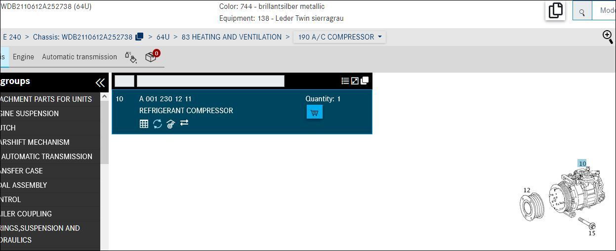

I found a very local MB wrecker who can supply a good 2nd hand compressor. Evidently there are 2 models of compressor, how do I get in to see the par number on mine or is there a way to find what part# compressor is on my vehicle? VIN: WDB2110612A252738

Old Feb 18, 2022 | 10:58 PM
ilium007's Avatar
Joined: Feb 2022
Posts: 10
2003 E240
Thanks again @konigstiger
