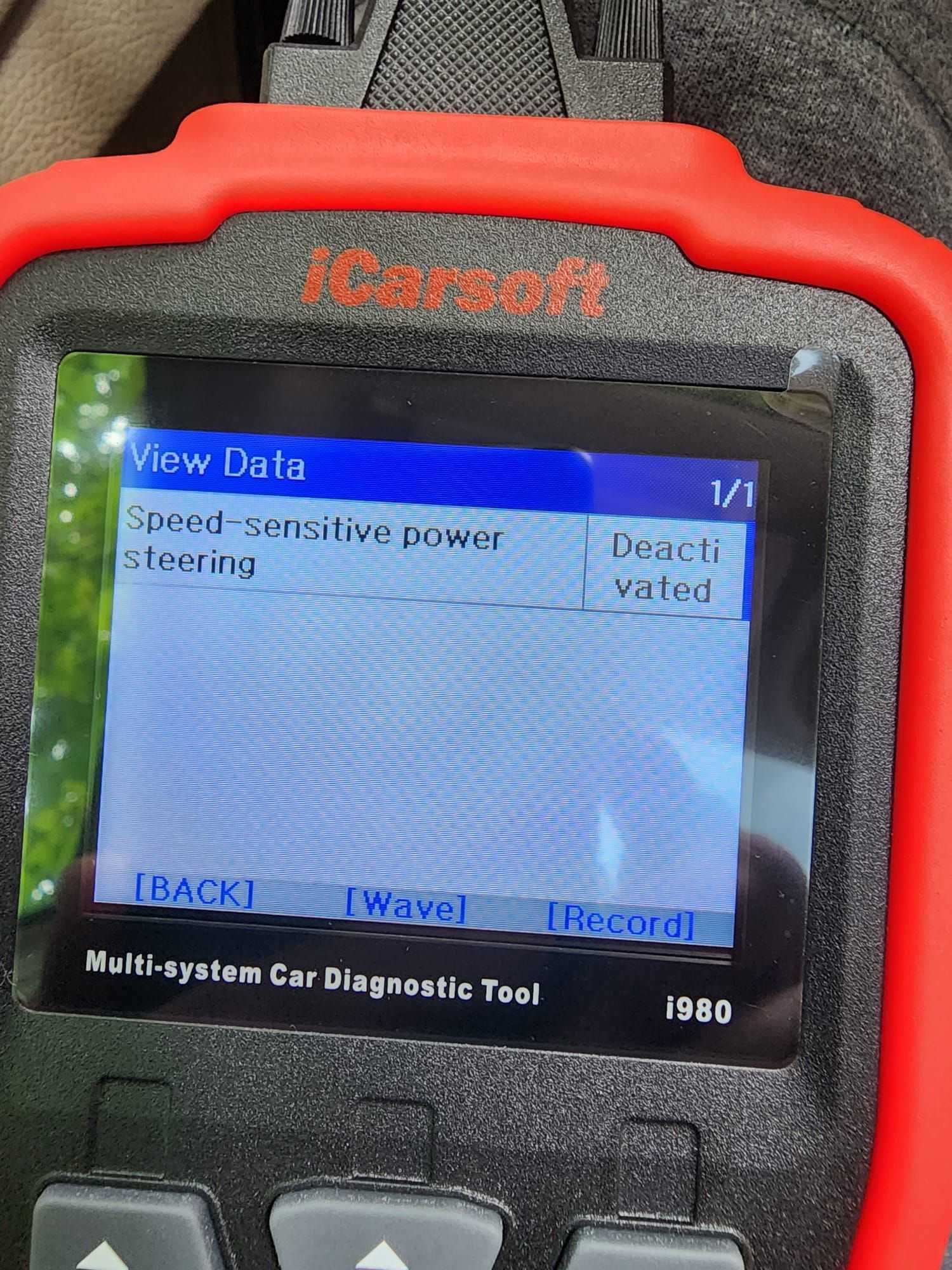

I just got my scanner today, the SPS is deactivated.
